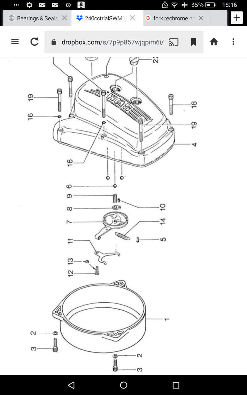

Does the clutch cable just attach to an arm of some type to push the clutch? Should there be a rubber to keep dirt out between the clutch cover and the cable . Or does the cable fit in and seal itself in.

Sounds good a photo would be nice, with the older clutch cover you need a clutch assembly with an mount to the case with an o-ring fitted. You get the cable from venhill or Mr. SWM.
Yes I'm very happy with the results and progress
 I'm working at her this Saturday so I'll take a picture
so the clutch assembly attaches to the case and unless you take it off on purpose it remains in place say even  if you remove the side cover to work at the clutch , is that correct?
And the cable connects to part number 7 is that correct?

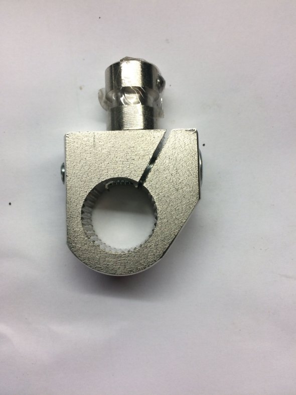

Great, hopefully you can ride it again in the next time; always good to hear that old stuff got running again.
Did you just got a new ambos or too the tiny spring and ball, then I recommend a very good allen bolt in high tensile steel, to fasten the ambos of the kick starter and a god stop washer, the fastening of the Rotax engine can be delicate.

There are two plastic plugs on the clutch casing, remove the rear one and check the adjusted has slack, ie clutch isn't effectively engaged. Check there is also slack at the lever.
Generally the issue with these engines is the clutch won't free off.  What oil is in the gearbox ?
So check if the little mechanism is not engaging the clutch through the plug, is that right?
I had about 3\16 of slack at the lever or a coin width.
1000ml atf dextron in the gearbox
Correct, cable may be slack but mechanism still partly engaged.
Atf is good, but check you have enough oil, there is a level screw in the casing behind the gear lever. From memory it's 1200ml.
The level screw is approximately in the middle of the case- looking at it wouldn't suggest it holds the case on is that right?
Is there a way of adjusting the clutch mechanism other than the cable?
Level screw is behind the gear lever as previously mentioned. Clutch adjusts behind plastic plug, take it out and you will see.
