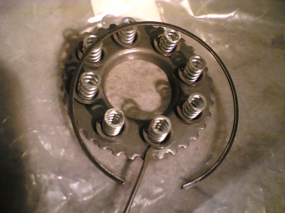

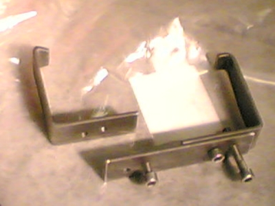

Hmmm.... I have the cover off, but am not sure how to get the clutch apart. Do you need a special tool to compress the clutch so you can get that ring out?
Ah Bugger it....I made one myslef...
Long screws on the outside compress the clutch. Short screws hold the two legs together (you need two separate legs cos you cant get a single tool in there).
Edited by KTMSprocket

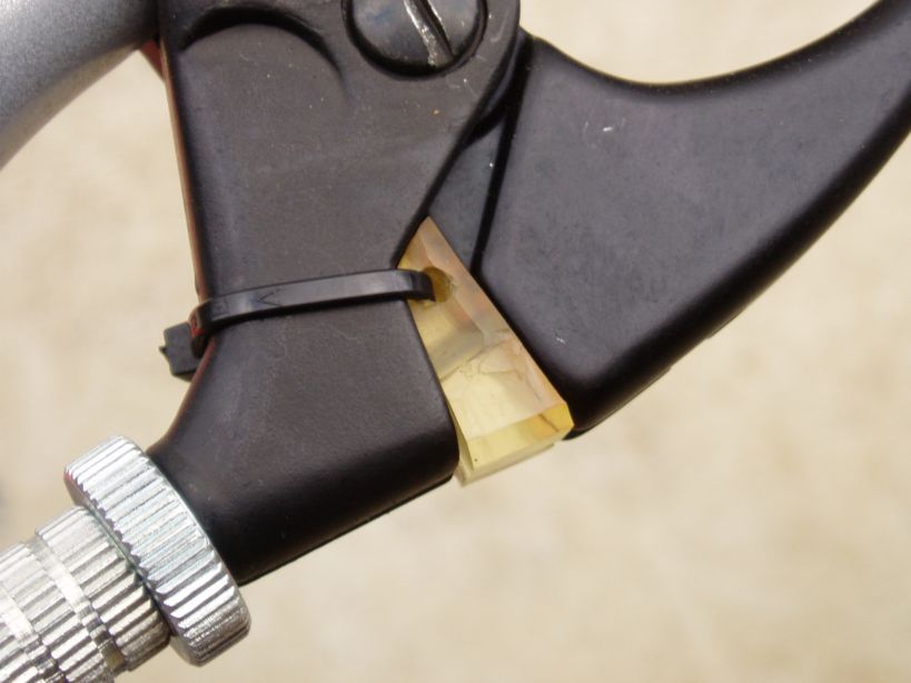

Beta Rev50 for my seven year old has the stock clutch perch, lever and no mods to the clutch itself. Yet the clutch is as light and accesible as any seven year old could need. How?
First I moved the perch all the way down the bars to near the bend. This put the end of the lever just in front of his pointer and index fingers, but too far out. (This also has the advantage that when he lays the bike over the bars usually hit the ground first.)
Then I made an insert or wedge that fits between the clutch and perch to bring the lever in towards the bars so he could reach it. See the picture. I used urethane because thats is what I do, but you could use just about anything that has a little flex. The wedge has a split to fit it over the cable, a hole at the end of the split for the cable to run through, and is held in place by a cable tie through another hole.
Honestly this took less than 2 minutes to make and setup. I trimmed the wedge until we got the lever spaced just right. Then a litle adjustment of the cable adjustors to get the break/engage point right.
Because we used the stock lever, last year when he had a big crash at an event he bought another lever from the dealers tent by himself (please put this on Dad's account), and fitted it with his brothers help. All they had to do was unscrew one bolt. All the adjustments stayed the same for him and he finished the event before I knew what had happened. Too easy

ps. i've used that lever 'stand-off' before for the brakes on cable pull type. Sometimes i put a bucket load of cable ties in there!!! Sometimes I do the elegant thing and tap a 6mm hole in the perch and run a screw in there. Only the best for MoToToM you know!!! ;-)
