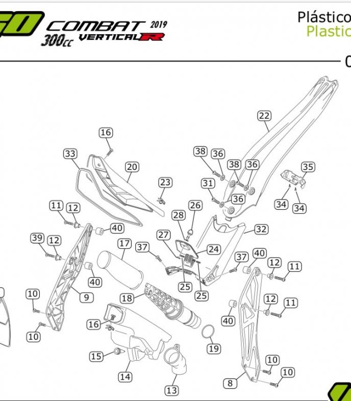

I have heard from a Vertigo mechanic that the new Vertical R has a "oil catcher tank" inside the airbox so that the oil won't get all over the place, but in the Vertical R parts diagram I cannot find the drawing or the part number code....

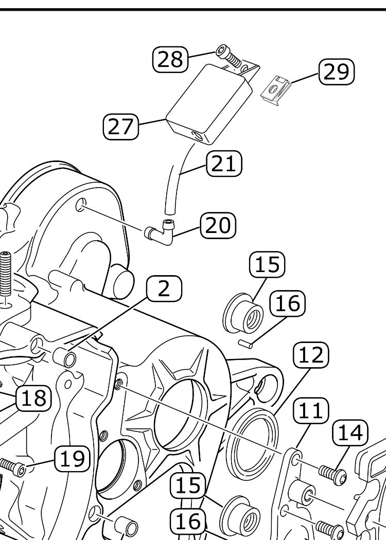

Page 21 of the parts book shows a breather box (number 27). That box is mounted inside the airbox on the left hand side.

I can't see the breather box you are talking about. Are you referring to the Vertical R 2019 part list?

Check page 21 of the book (that is the page with the crankcases on it)
Ok, found it. Thanks!
V-1616 breather box

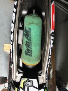

How do you figure out how it's fitted inside the airbox?
@sergioNMD; I followed the tube that is going from the crankcase to the airbox. Just remove the airbox cover and you will see the box.
Yes, I see.
The problem is that I don't have a Vertical R handy to disassembly at the moment, that's why I'm asking B)
A picture would really sort me out.
The breather box is on the left. And I know that the filter needs to be changed...

Perfect! Thanks a lot @tcrhino!!
