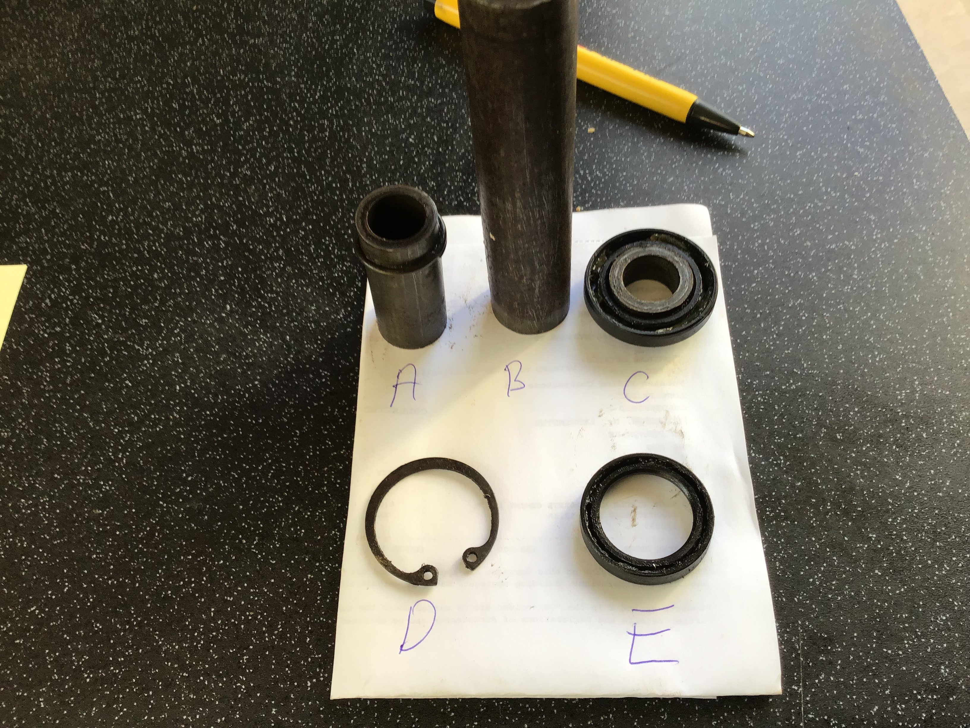

Had my wheels rebuilt from my hubs
a bag came back with the parts in the picture don’t know if they’re back or front
or which order it’s a fantic 240 I’d like some help

Robbo,
Hopefully you are not still trying to put this together, but here is the information you asked for.
A is the spacer between the two front wheel bearings
B is the spacer inside the back wheel
C looks like the front wheel bearing ( Size 6202 on my 200). I hope you are replacing it.
D is the circlip that holds the brake side bearing in place in the front hub
E is the front wheel seal (25 x 35 x 6 mm)
Regards,
Peter

Thanks for getting back to me ,
it is sorted now found the exploded drawing on here it’s helped a lot
It’s a steep learning curve when you don’t know
the wheels are great new bearings fitted with spacers inside!
