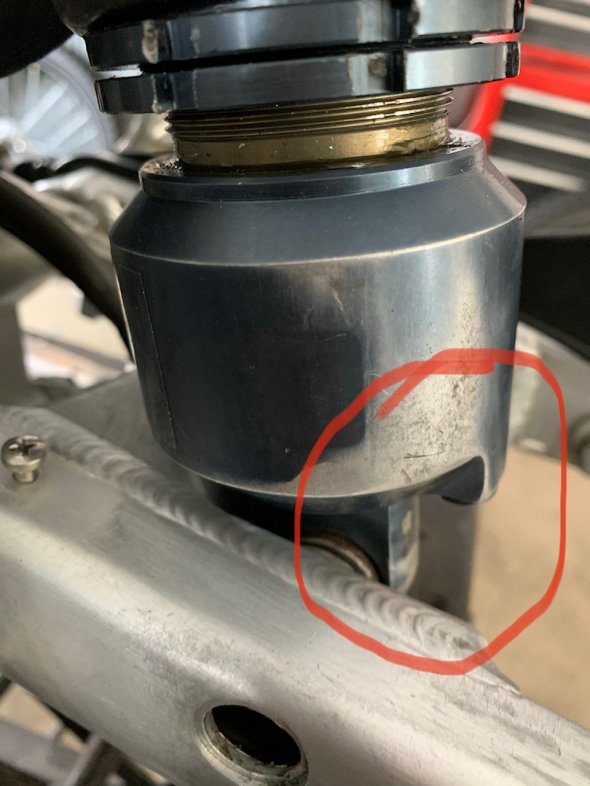

Hey Guys,

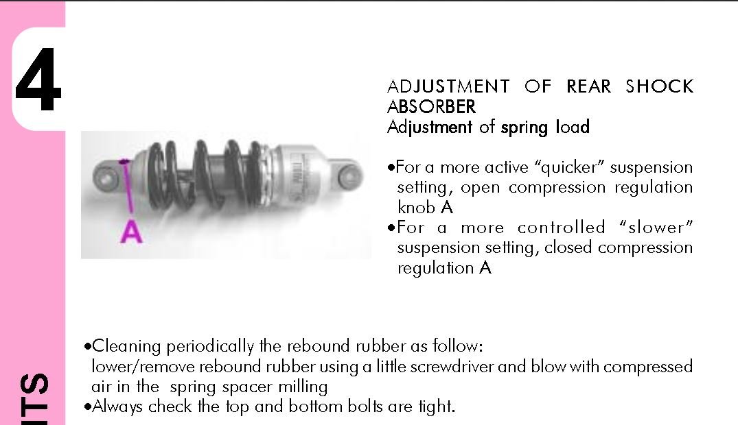

New to this trials thing and have been diligently working to assemble a Rev 3 270 - when installing the shock, I am assuming the rebound screw (at least I am assuming it is a rebound screw) faces the back of the bike?
Thanks for the help!
Adjuster at the top as pic
Edited by Bilko
Thanks for the photo!  I thought the adjuster should be at the top of the shock but when I purchased the bike, the shock was installed upside down and I noted there were several other examples on the internet whereby the shock was installed upside down and  was I therefore thinking that it was some type of after-market mod?
