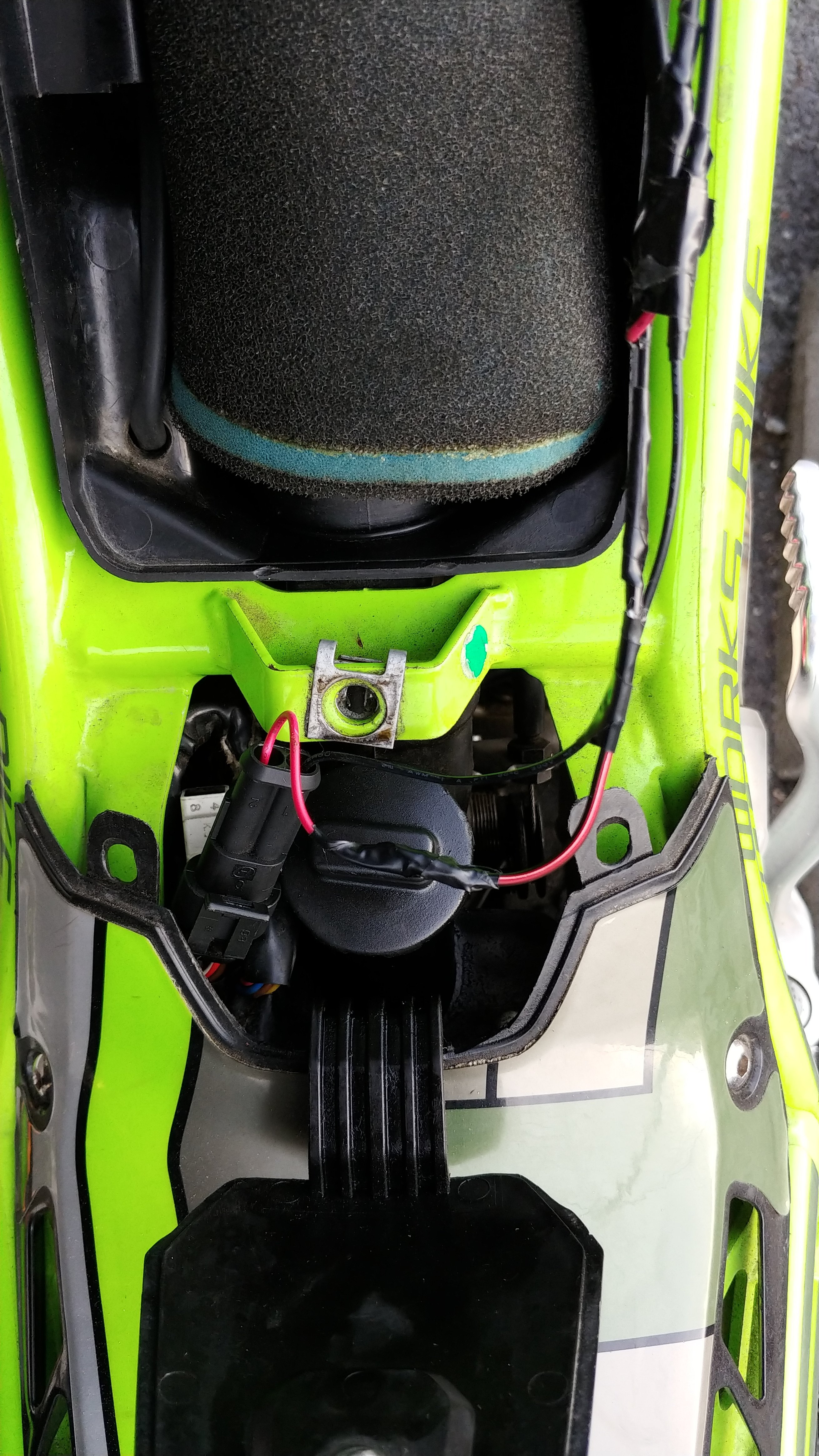

Vertigo 12v start battery connection is inconvenient

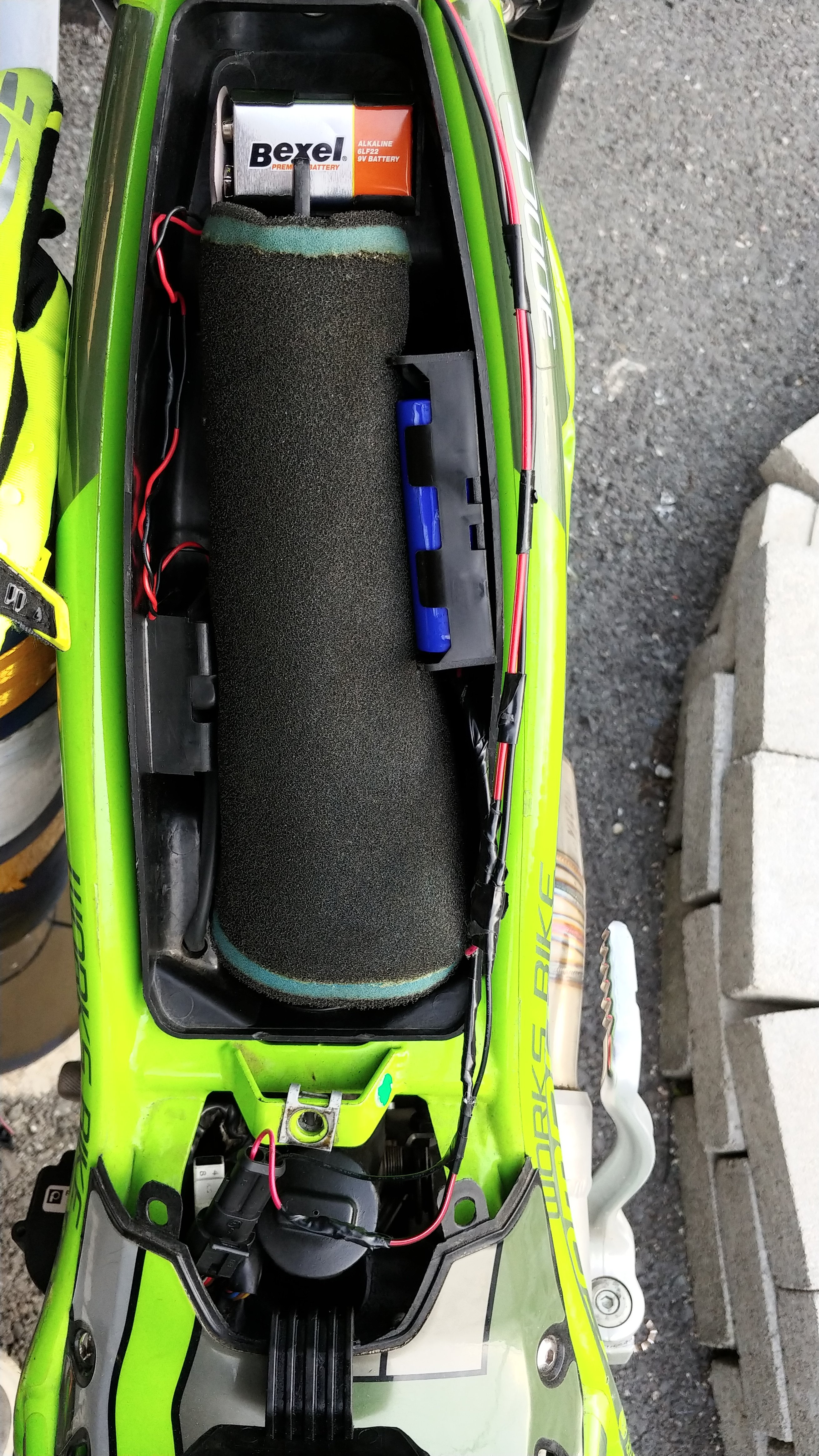

So I made a 12v portable starter battery with 18650 batteries.
It is 11.1v by connecting three 3.7v batteries, but 12v comes out because it is 4 volts when fully charged.
In the photo, the battery hold is on the side but is actually under the air filter.

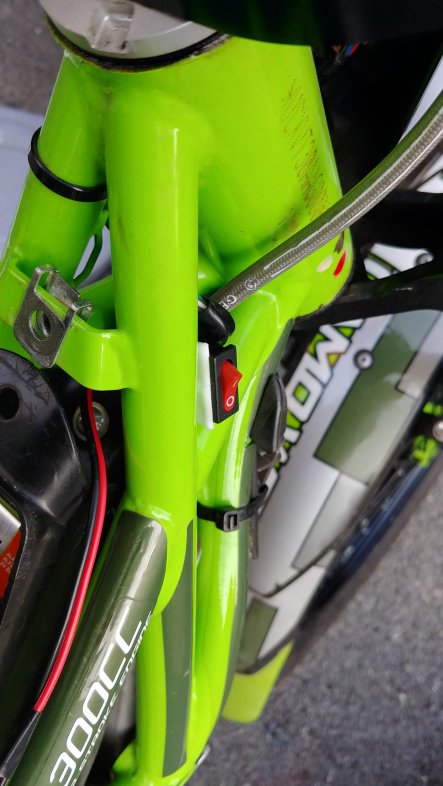

Make a switch and start the engine When started, disconnect the switch.
If the switch is connected and kickstarter 3 starts.

The idea of an external power source for easy start is very good.
But it's a bit uncomfortable.
So I made a small 12v and a switch.
It is very easy start after installation and is comfortable.

Can you tell me where you wired the 12V supply to?
