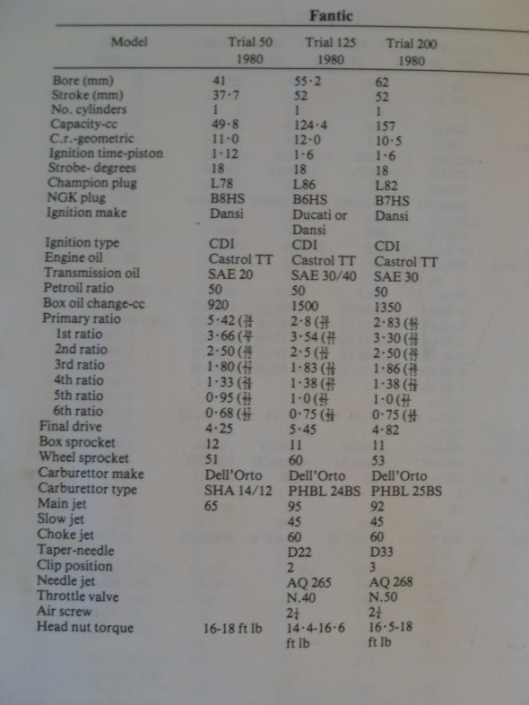

How much gearbox oil do you use in these engines? 1350 seems an awful lot of oil for a little engine. I guess it could help the cooling.
There is a level plug in r/h casing
I think 1000ml is the max, start with 750ml and top up and when the oil comes out the weep hole, remove the screw when doing the oil, then there's enough. Replace weep hole screw and ride.
