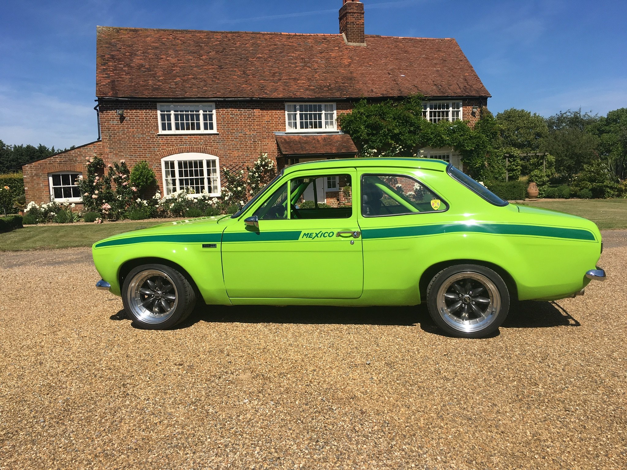

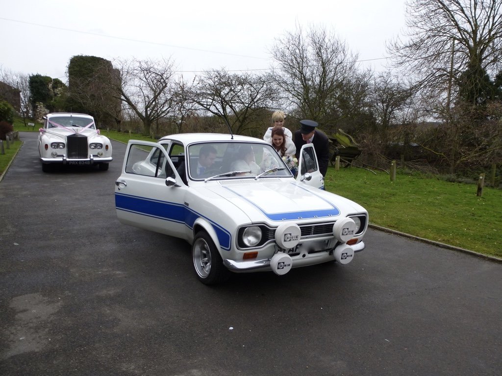

Funnily enough my Mrs's son rebuilt this.....
Nice, I always liked the white and blue RS200, the dreaded virus I’m sure will hit London hard again bringing lock downs like earlier in the year, I rode my road bike through London and could not believe what I was seeing, it was just like normal, masses of people walking around closely together.  It could go on across the world for another year or more, especially if the thing mutates as people catch it more than once. I really hope I’m completely wrong.  I’ve been thinking of building a few objects to practice on in my garden, best I fill up my fuel cans in case the petrol stations shut to restrict movement.

Sorry, I was a bit shocked by the news that we can't ride last night. That's a lovely Mexico, love the colour too, I was a fan of the Mk 2 RS, largely as my mates at the football club had them and we used to race back from a match to the pub. Seemed the height of cool back in the day.
