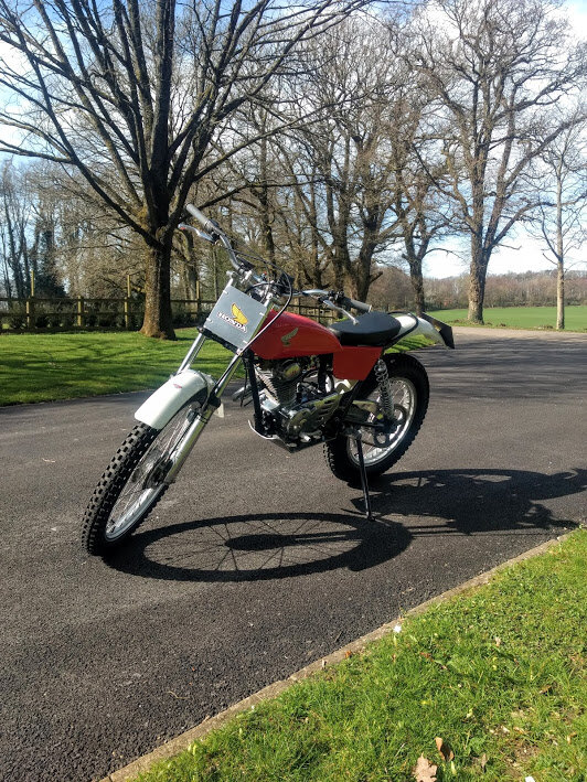

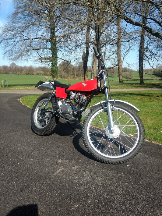

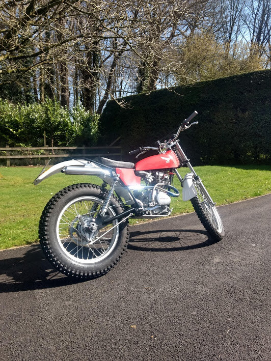

The little TL is back on the road and the first ride was last week when it just happened to be the hottest day in March since 1968!  It ran well, the drum brakes leave a little to be desired and it photographed well, all that polishing paid off  ;o)
