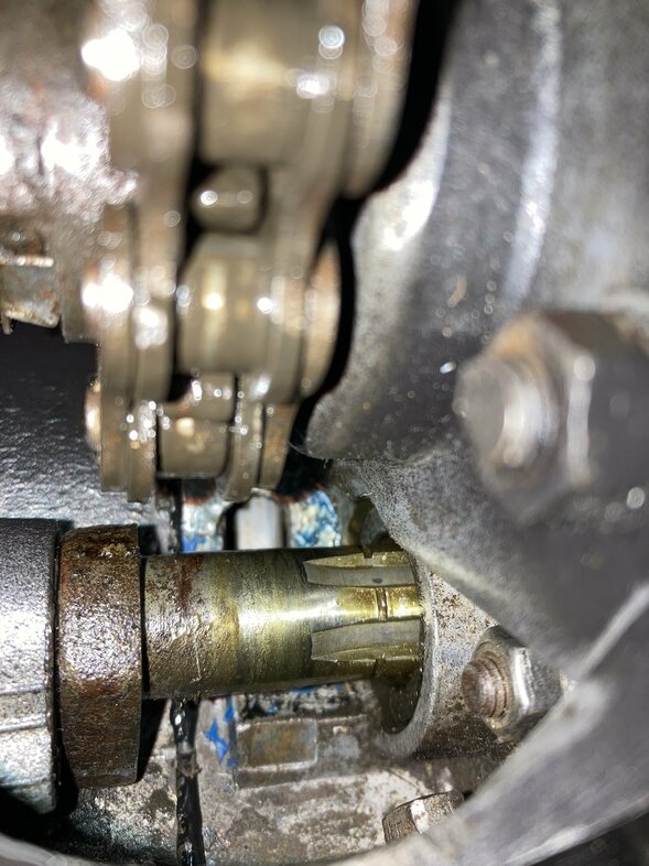

April 3, 20215 yr Author Hello Guy, This evening I checked the detent plunger on the right hand side of the engine, this was fine and working well. Next took off the clutch case and removed the selector ratchet mechanism and plates etc all which seems ok but with a little age related slack mostly caused by some wear in the selector lever shaft bush in the clutch outer case. I took your advice and connected some mole grips onto the selector drum shaft splines and went up and down the gears while gently rocking the clutch or rear wheel: the shaft was quite stiff and difficult to move to select the lower gears 1st, 2nd and 3rd, whereas 4th 5th and 6th were definitely easier with shifting back down the range being more precise. Interesting to note that the difficulties in movement with the selector mechanism removed were as replicated when they were connected and worked through the shift lever. This has more or less confirmed my suspicion that the problem is within the gearbox somewhere but unfortunately it is not a place I am familiar with. Where to go from here? The bike is great and having apparently not being started or ridden for years it now starts, runs and pulls really well but I am a bit reluctant to open the gearbox up. But I like things to be right and ultimately it may be the only way to see what is causing the problem and get the bike right again. Thanks for your advice anyway, it's much appreciated. Joe

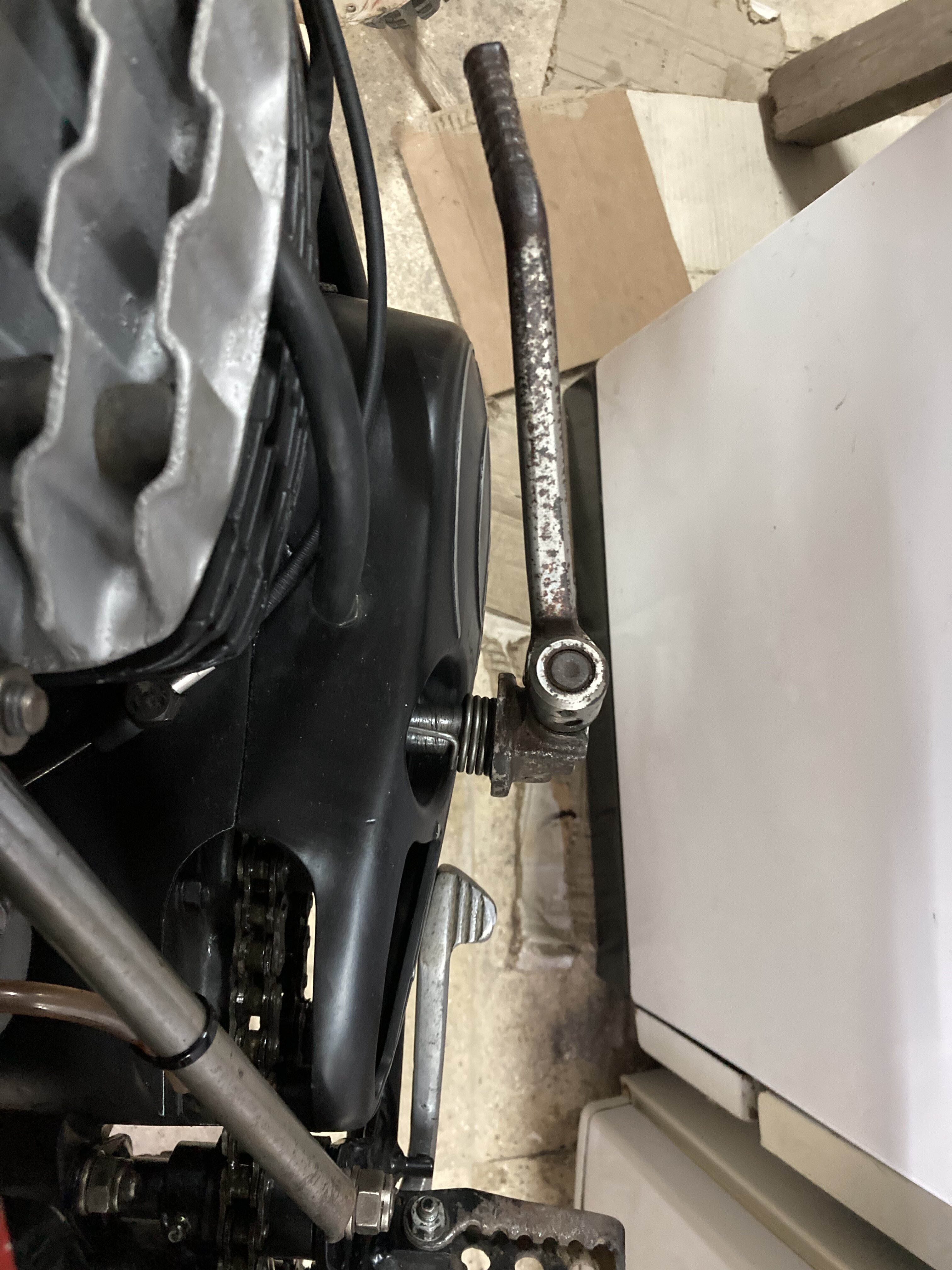

October 24, 20215 yr On 4/5/2021 at 11:56 AM, barnesy said: Hi Joe, It looks like you've done all you can without splitting the cases, if you decide to go ahead and split the cases I'd say its a finiky rather than hard job take lots of photos and make a note of what order the shims in the gearbox are. With my bike it ran well but was noisy compared to other 348's I'd seen at trials it turned out to be the rod/big end bearings that were worn. I replaced the gearbox bearings and main bearings while it was apart these are relatively cheap and available from inmotion (other supplier are available..). I'd never split an engine before so was a bit daunted when I started but the bikes runs great now so I'm glad I persevered with it, there's lots of info on these forums and feel free to reach out if you need any info/tips. Cheers Guy Hi Barnesy, I have a problem with my kick start shaft on my 348. Yesterday went to start the bike and when I kick it it moves forward. I’m sure it was in Neutral. Than I’ve kick it again and it turned free and moved to the out side. This problem never happened to me on other cotas. Do I need to split the cases?? I will appreciate any help as I live in a country that classic cotas are very rare. Thank you 🙏
October 25, 20215 yr Hi NFC, Unfortunately I think you will have to split the cases as the kickstart shaft is held in place by a circlip on the other side of the case and this looks to have dislodged. The kickstart shaft locates in a bronze bush in the other case and this can wear (as mine had) which may have contributed to the shaft dislodging. Sorry to be the bearer of bad news...
