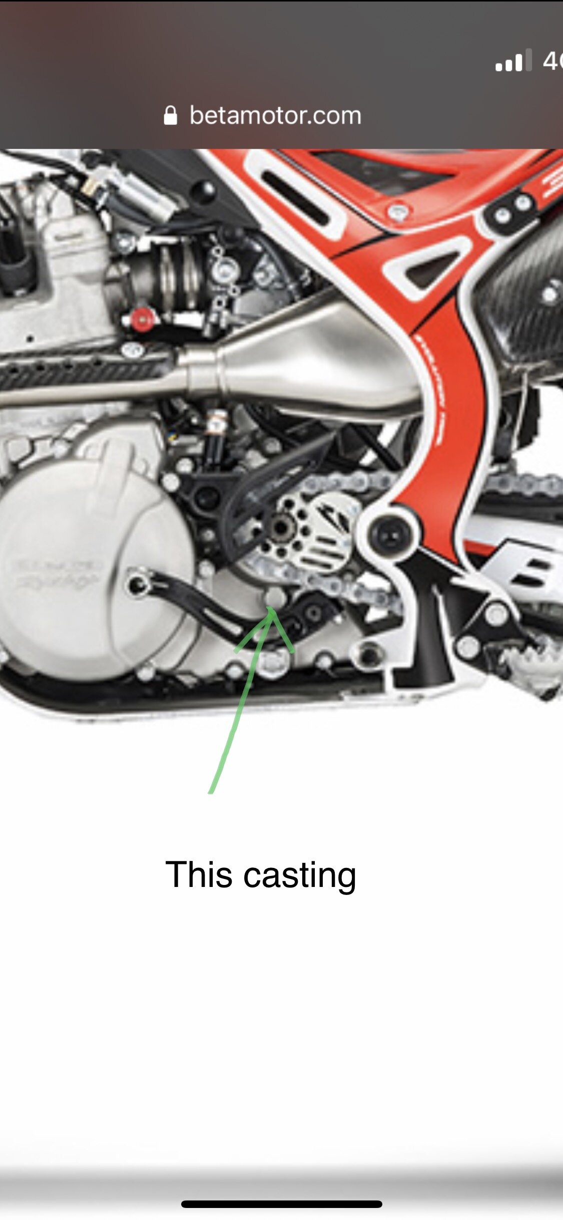

51mon Posted April 27, 2021 Report Share Posted April 27, 2021 Before you get carried away, it’ll be worth checking something simple that caused the exact same problem I had on mine.... The gear change had come slightly lose and worked its way inboard, enough to be rubbing on a casting on the engine. This was enough to stop the lever returning on its own. Hope that helps. Link to comment Share on other sites More sharing options...
rrefugee Posted April 27, 2021 Author Report Share Posted April 27, 2021 I looked in to that first thing, unfortunately that isn't the problem. Link to comment Share on other sites More sharing options...
