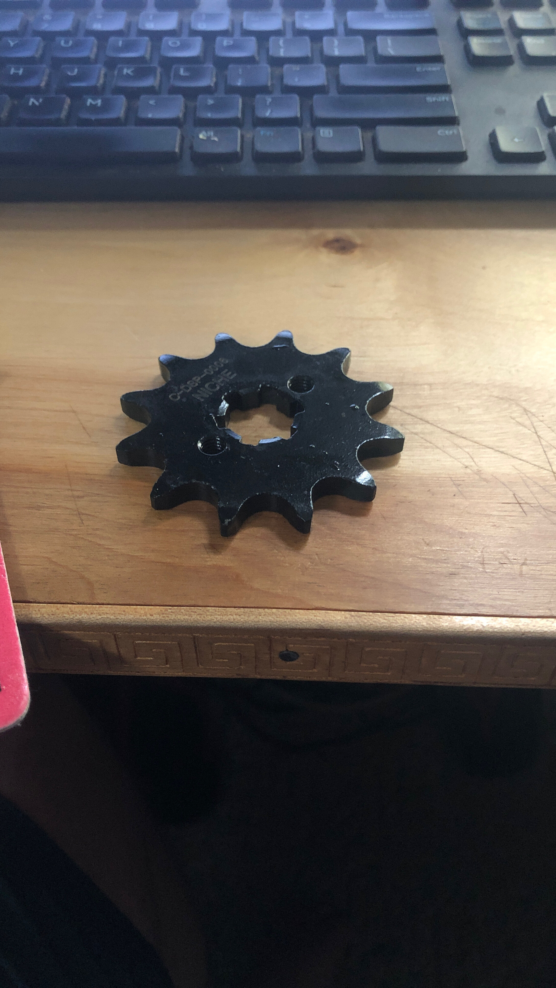

Posting this here as i know i will want to refer to this again someday in the future. As im modifying my 175 with 350 mono stuff i needed to go up to a 520 chain but my counter shaft sprocket has been a PITA to get right... so here it goes.
Dear future Biff,

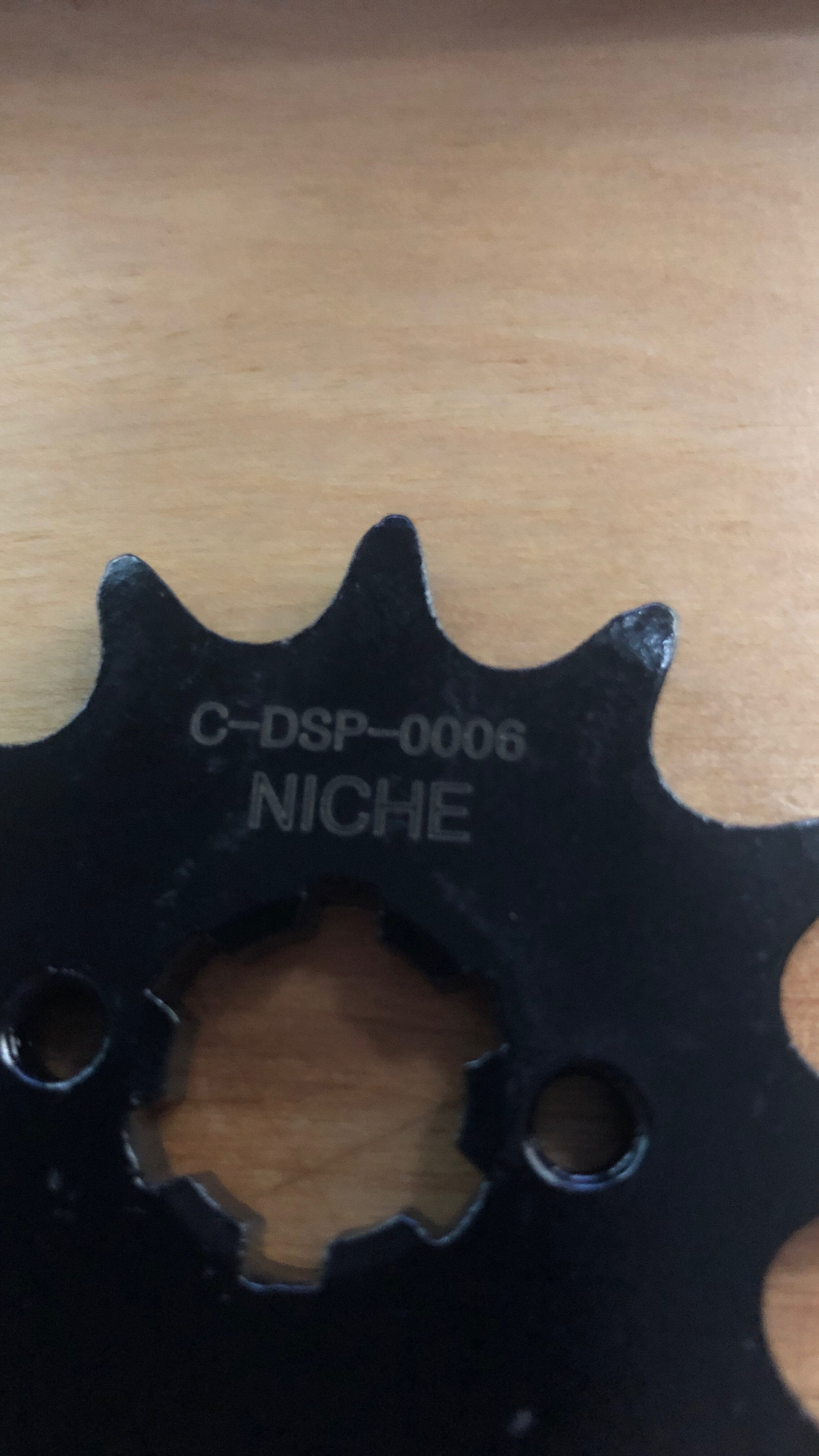

        Hows it going? Wow yea i can see you haven't missed a meal. Well as you asked the counter shaft 520 sprocket from a 1980-1993 kx125 will work on the Ty175. Stay well bud!
--Past Biff
talon tg109 will do the trick as well but you didnt want to wait the several months durring covid for uk shipping...
