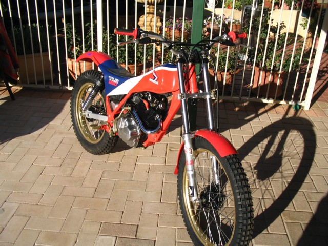

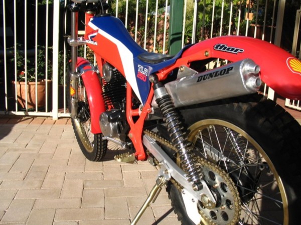

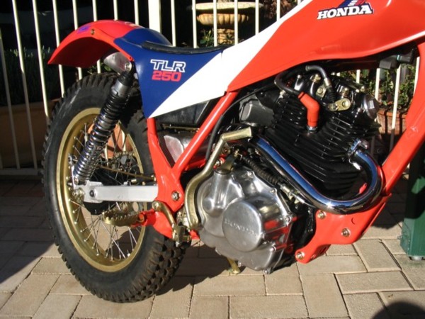

Hi, to add some pics of my tlr make over before it's ridden and may not look the same again.
Miked
Very nice bike.
How does the WES exhaust sounds?
Does it makes more nois then the original.
I ordered the same one,thats before i saw the REP one.
I think the rep looks nicer because its shorter.
So i think i am going to shorten te Wes if its possible.
What kind of rearshocks do you have, and where did you get them?
Greetz Rob
