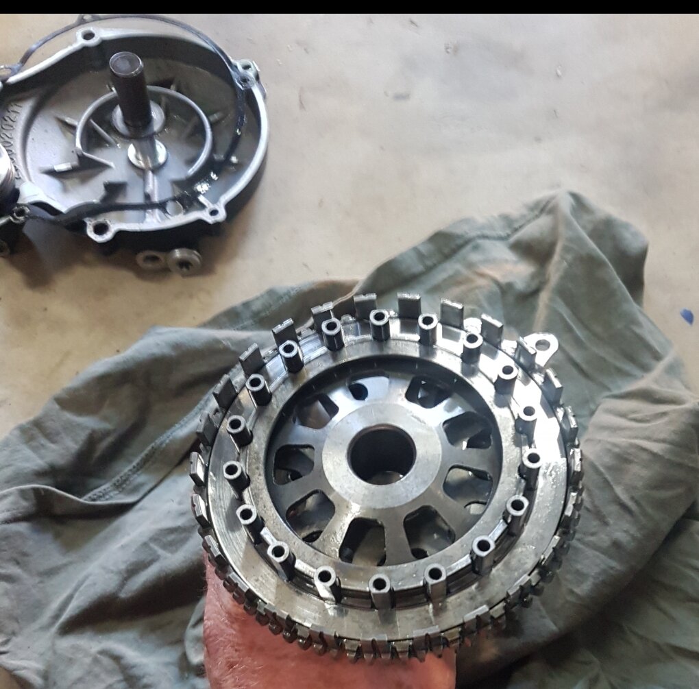

I have recently picked up a non running Tr280i that has been hand balled though a number of people of the last year or so.
I was told it may have a clutch issue. After inspected it I found the clutch was completely missing. The only parts there was the hub and basket. I can buy the plates, fingers and a local shop is conforming the availability of the pressure plate and support plate.

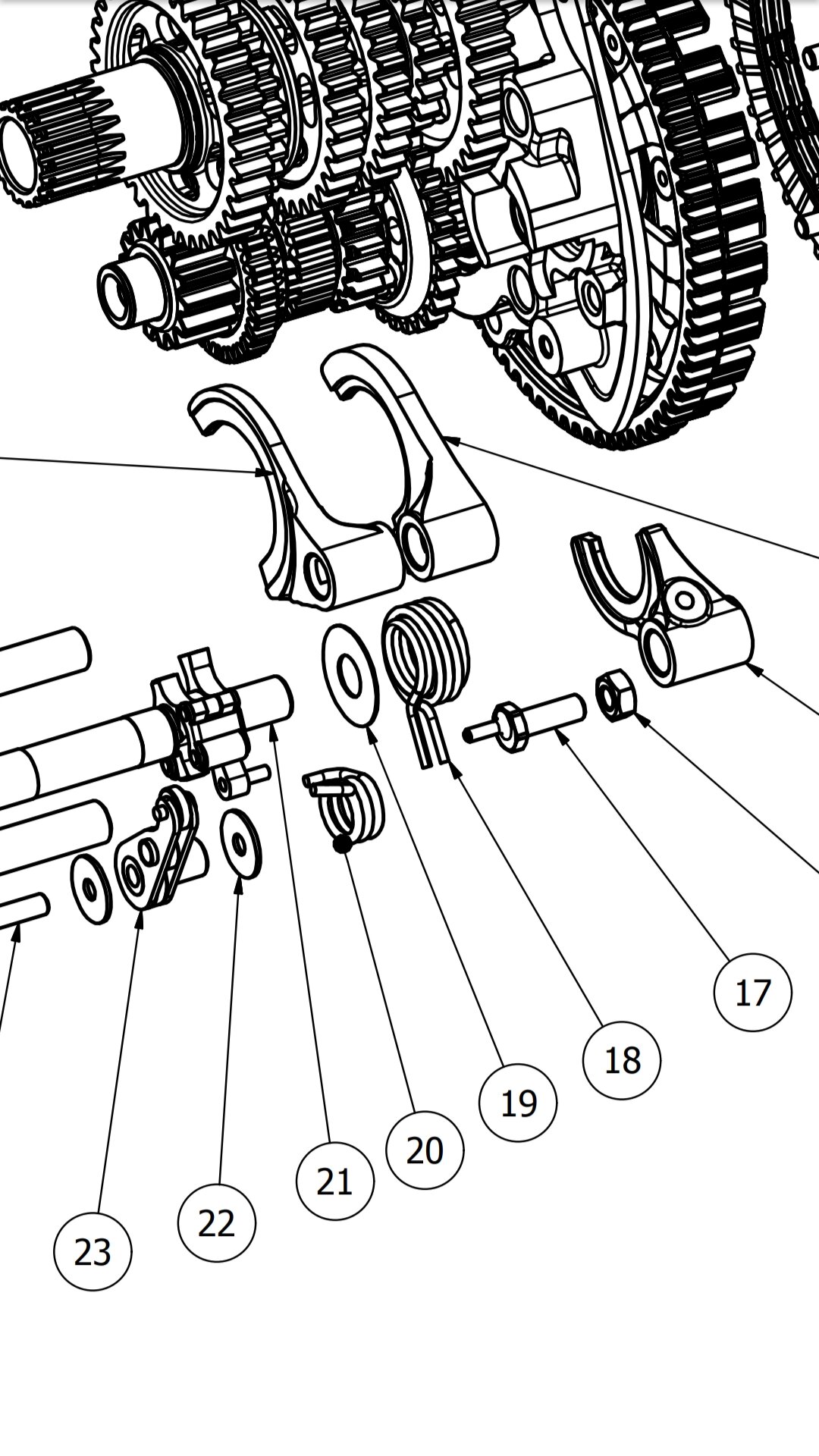

However I'm having an issue trying to find the clutch spring (number 12 in the part diagram #2420020212) does anyone happen to know where I maybe able to find one or does anyone have a bike they are parting out?

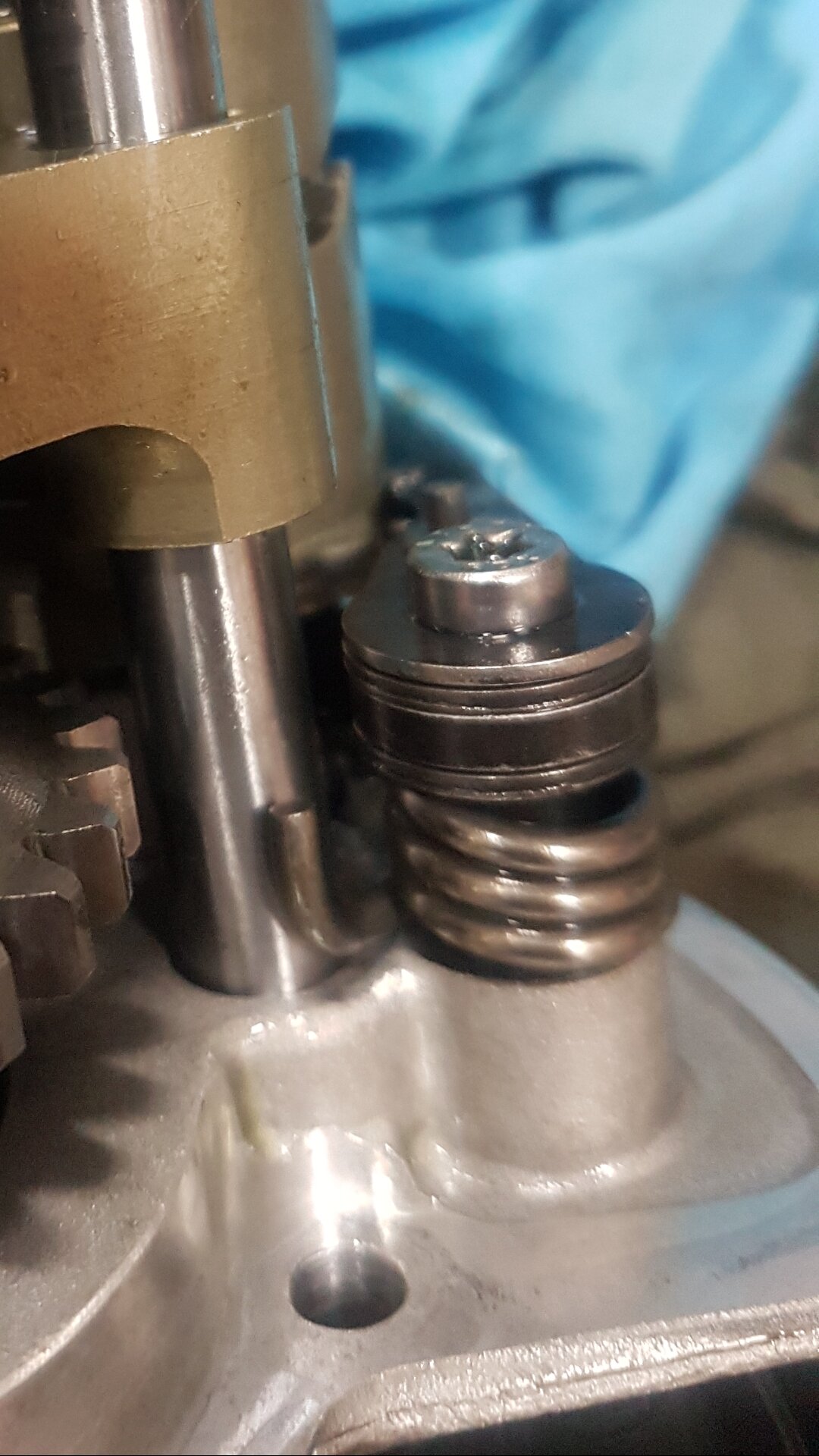

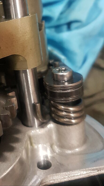

I also believe my gear selector spring (number 20 in the parts diagram #8130020211) is damaged. Is anyone able to confirm this? As it just doesn't look right and I'm not able to tell from the parts Manual.

I have also confirmed that number 20 spring is undamaged however the shift returns spring number 18 has snapped both legs.

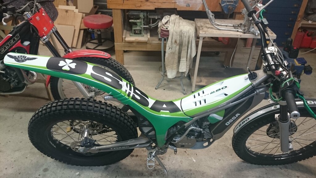

BTW I like your paint job, I think it might have been the inspiration for when I painted my spare plastics "way back when".
