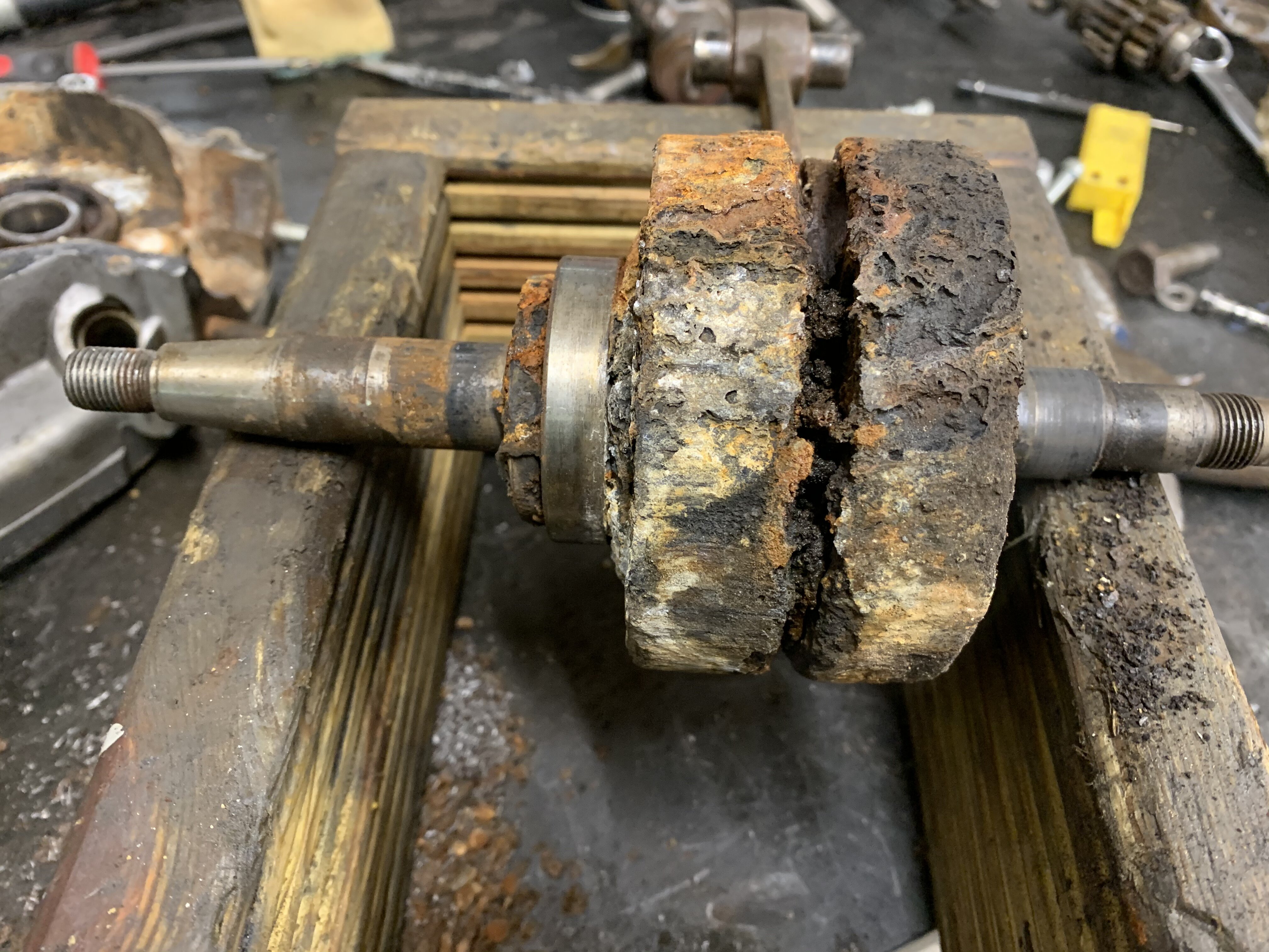

work done,
Engine rebuild with fresh crank form a uk bike, I used a +1.5mm piston taking it out to about 125.
New GSX 125 forks with home made top yoke.
Steering angle reduced by 4 degrees
A100 front hub Honda Cub back hub laced onto alloy rims
Swing arm extended by 40mm.
Plus much more!

Ikb, Now that is great. Just what I am very interested in. Very impressive. Thanks for posting the photos and giving those details of what you have done.  I have my eye on a bearcat kt120 frame but it is a bit expensive. I will try and negotiate. Also found a second swinging arm. My word, that crank was bad. My first TC was solid. Had to drill out the piston crown and carefully chisel out the rest. Manage to do it and save the barrel.
Do you mind me picking your brain a bit more.

Is the bottom steering yoke/ tree from the bearcat?
Is there any reinforcement were you cut the back the rear mudguard area?
 Re: steering angle change, I can't see how you changed it.
Is there any particular year for the forks you used?
Wheel sizes?
Appreciated.

Hi,
The triple clamps are standard lowers with a home made top.
The forks are GSX 125, they were brand new old stock genuine Suzuki I may have the part number somewhere. However they look better than they perform! Really they are too long but the sliders are too short giving only 4” of travel, the springs are too hard so I have some borrowed TY175 springs in at present and I have extended the damper tube to increase travel. I plan to extend the sliders and fit a decent mudguard bracket on.
Wheels are 18 and 21.
The photos are before the steering angle change.
Where the rear frame is cut it is only the single skin bit so no reinforcing needed, I have added more welds though.
Ian
