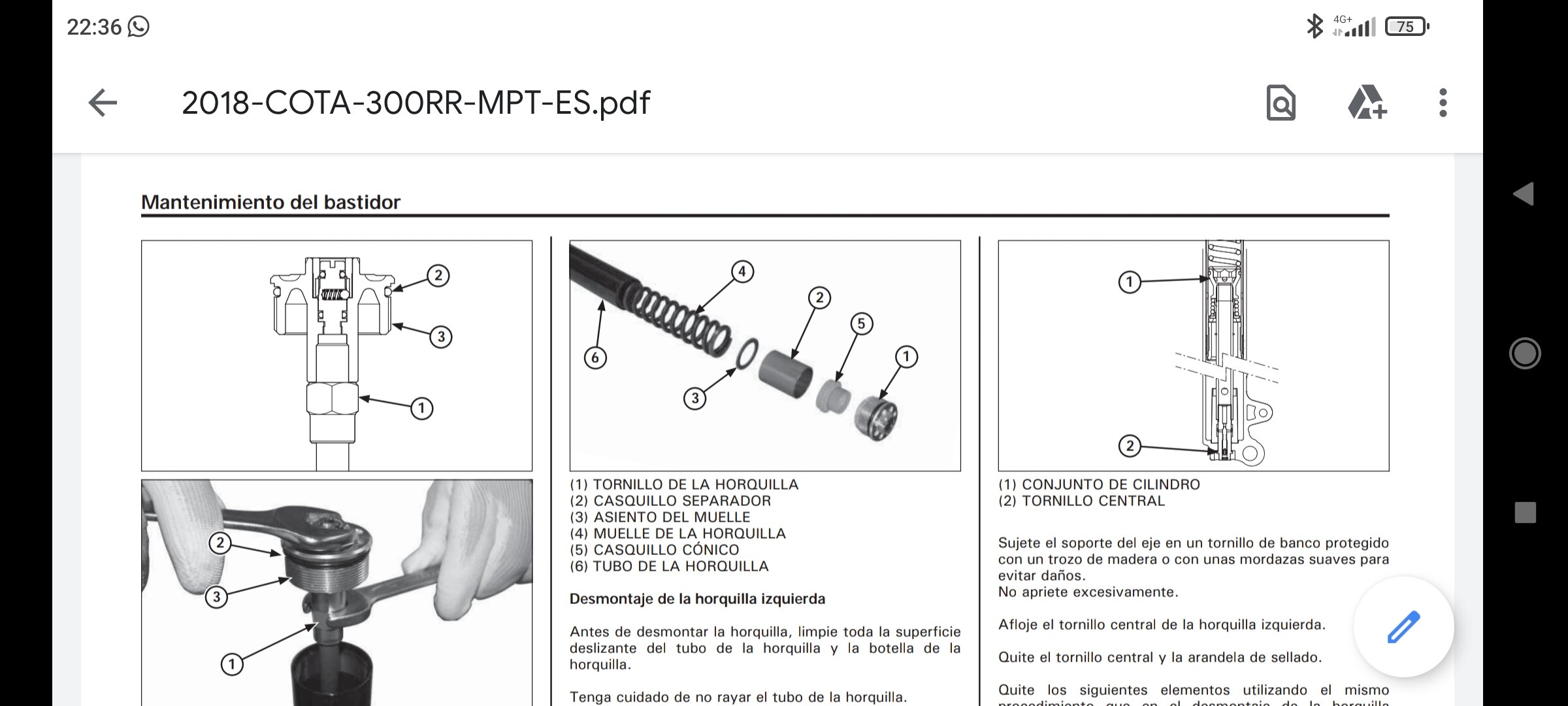

I own a montesa 300rr 2018 and I have a problem with it., he bike is very low from the front, the static sag is very large even with the spring fully preloaded.
Looking at the user manual, the spacer bushing in the drawing is much larger than the one on my bike, at first glance about 4x more, but since it does not give measurements, I cannot verify it.
Does anyone know the size of this cap? I also have a vertigo with a similar fork, but this spacer does not match, so I would like to know the measurement of a 300rr like mine.
at all times I am referring to the spacer bushing, marked with the number 2 in the attached image.

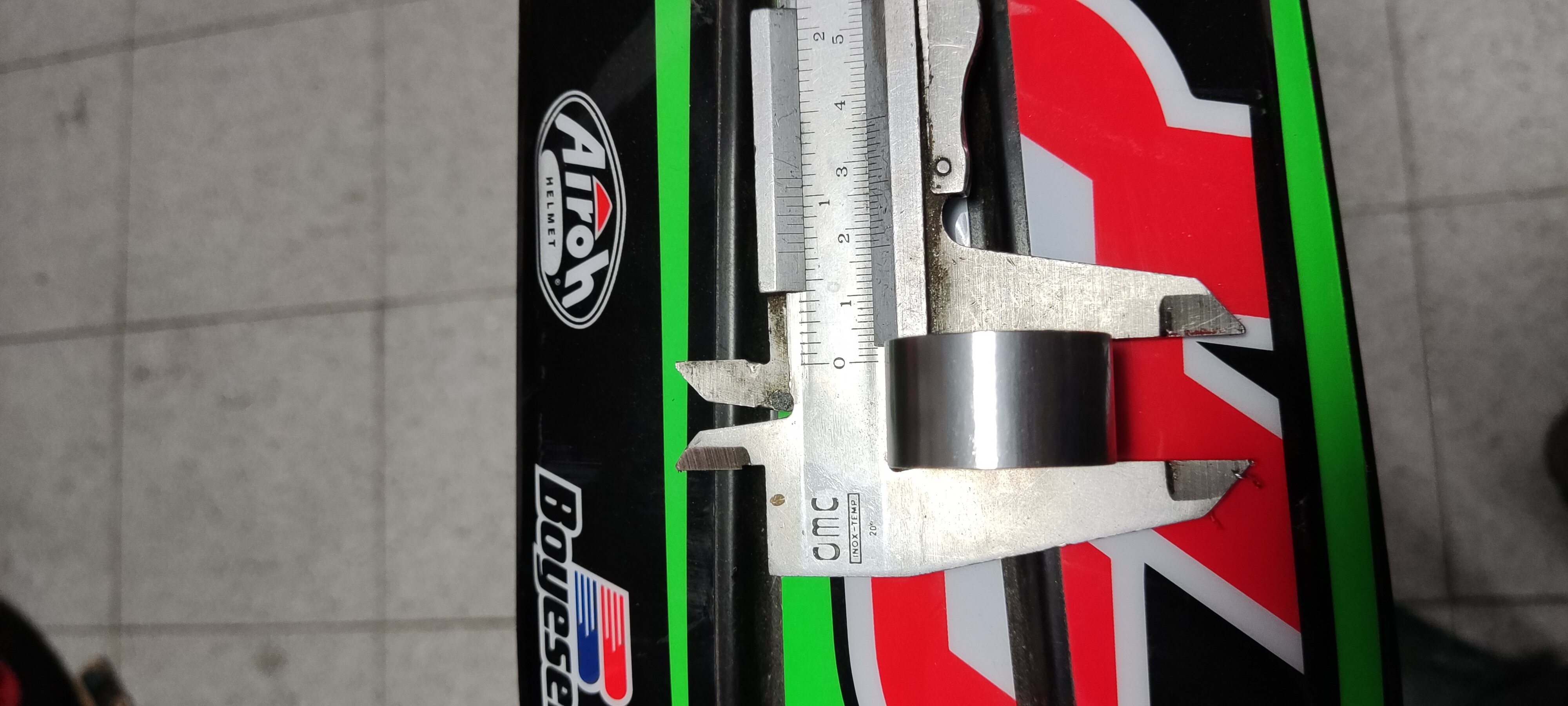

I have disassembled the vertigo and as you can see in the attached file, the bushing measures 17mm, that of the montesa 11mm, neither of them coincides with the image in the manual. (the spring of the montesa is 4mm longer than that of the vertigo and also thicker, even so the montesa is much lower than the vertigo)

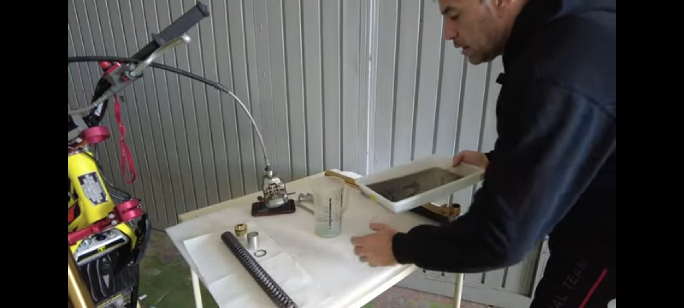

however, if you look at the attached frame of a maintenance video of a tech mounted on a trs, it does look much more like the one in the manual. which leads me to assume that each brand mounts different springs and spacers even if it is the same fork.

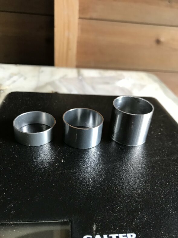

I had the same issue with my 300RR. For me it started when the front was solid when cold. I discovered the previous owner had put heavy oil in so I returned it to standard spec. Then it was way too soft. I found two things; firstly, the spring was a soft one so I replaced with a standard spring. Secondly, I found the spacer was like yours, looked to be smaller than standard. What alerted me to the problem was that there was no resistance when I removed and then replaced the top cap, almost like the whole assembly was too short.

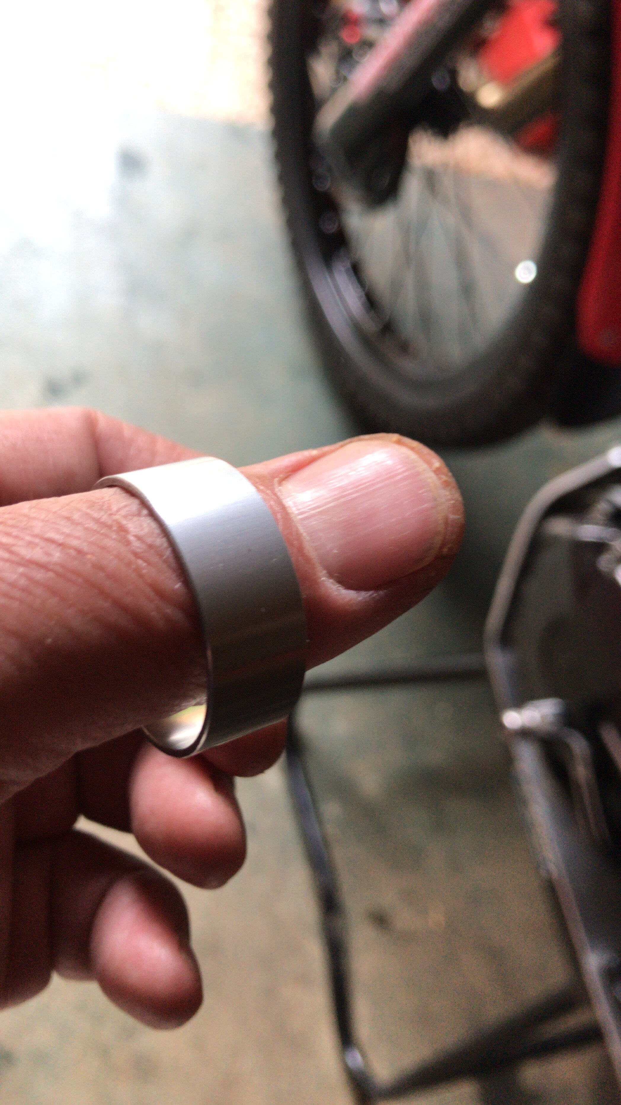

I made up a replacement - double the size - and immediately improved the situation. But I was keen to get to the standard and correct spec so I ordered a replacement (I bought this from Splat Shop UK, Tech do a kit with the nylon cap and spacer. It was somewhere between the two extremes. You'll see in the pictures, the small one removed, the middle one is the standard replacement and the large is one that I made. Hopefully, this will give you some idea of the size. Sorry I can't measure as the bike was sold.

Thanks, it's a great help, luckily I have lathes so machining that part doesn't take me more than two minutes, as you wanted, what I'm looking for is to start with a standard configuration, my bike is also second-hand.

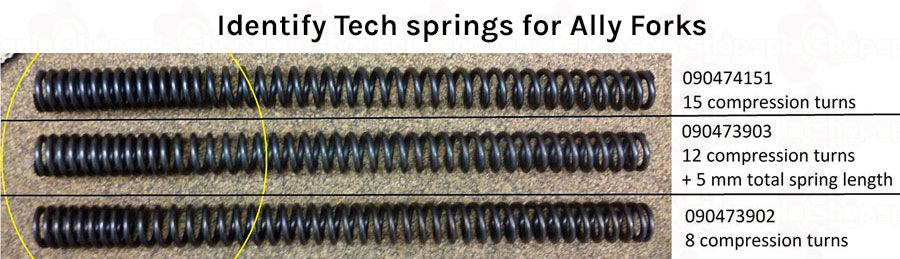

Here's a link from Splat Shops site regarding Tech Springs for Alloy stanchions. You can identify the spring by the number of tightly wound turns. You probably know this already but the oil recommended is an OJ product which we can't get in the UK. Comparing the specification the nearest product that I found was Motul Factory Line, Very Light 2.5W.
As you say it is easy to make a spacer. I'm sure that it will improve matters.

I am intrigued as to why our spacers were both smaller on our bikes. With respect to the springs, Top to bottom, they are heavy duty, Medium and Soft. I installed the medium and all was well. The 2.5W Motul is the equivalent of the OJ 5W (and also Showa SS05).
