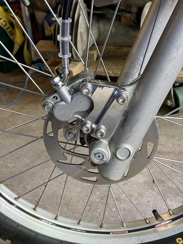

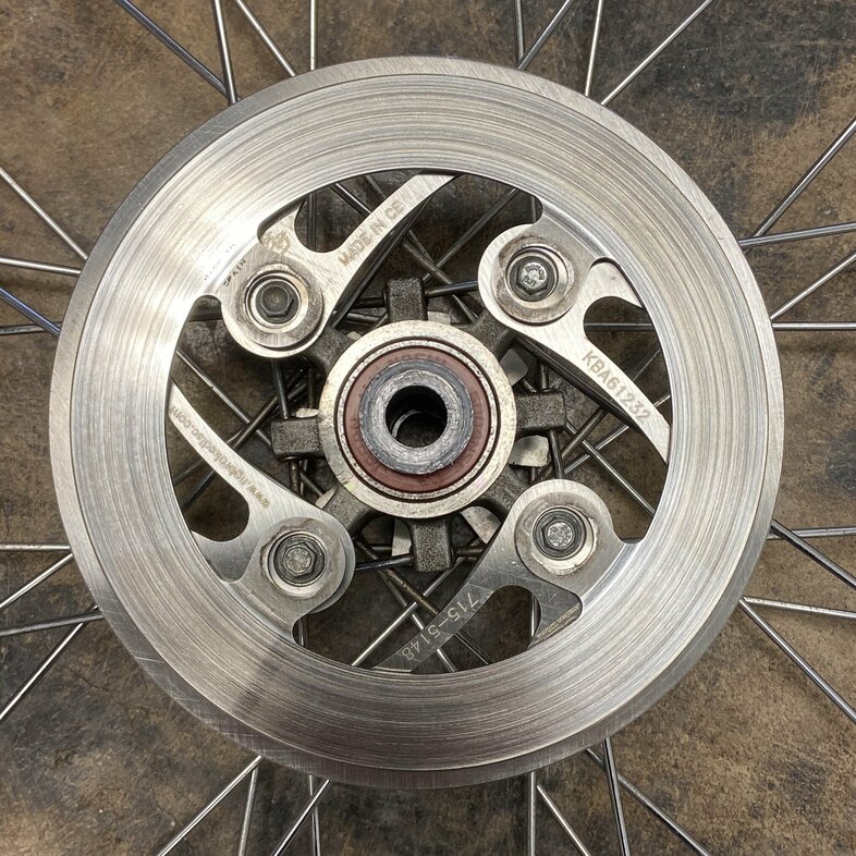

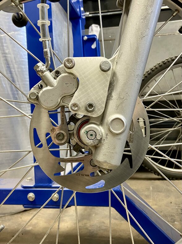

I picked up a new 185mm NG front brake disk (labeled GasGas, but identical to the Sherco), to replace the worn 173mm front disc originally fitted to the ST80, with the 33mm front forks. There didn’t seem to be any options for this size, and the new disc was cheap enough to take the risk to try and make it work.
Pic below of the old disc over the new.
I’ve had an old manual milling machine collecting dust at my shop that was inherited by my partner.  It needed a plug and some minor repairs, so once sorted decided this was the perfect project to learn the basics.  I designed and 3D printed a mock-up of the bracket, to test fit the caliper and make sure the dimensions worked, then used that print to base the aluminum bracket on, as seen below.
Milling the aluminum adapter was like a dangerous version of etch-a-sketch, but it somehow worked out exactly as planned  over all I moved the caliper 6mm further out from the existing location  It works quite well, but I’m sure once the caliper and master has been rebuilt, along with a new brake hose with the appropriate banjo angle, it will be more brake than I’ll ever need!
Thanks for reading, and have a great weekend!  🍻
