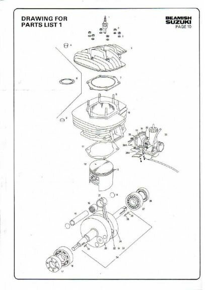

diagnosis Posted September 28, 2023 Report Share Posted September 28, 2023 I was planning on doing the seals as well on my RL250, thinking it’s the same as the Yamaha, but unfortunately splitting the cases seems to be the only solution. You can see the seal (#17) behind the bearing in the diagram below. (sorry about the poor image quality, the size limit was only 80kb 🤷) Quote Link to comment Share on other sites More sharing options...

LaVern Posted September 28, 2023 Author Report Share Posted September 28, 2023 Diagnosis, I guess I won't know until I take the side cover off. I won't be doing that for a few weeks at the soonest. I tried to convert the parts list but apparently I was allowed only one conversion frompdf to jpg. Anyway, the parts list says pts 17 and 28 are crankshaft seals and it shows them on the outside. I did not have this information when I first posted the question. I do see that the picture you posted seems to show at least one of them on the inside and one on the outside. Is that what you see? LaVern Quote Link to comment Share on other sites More sharing options...
djr Posted September 30, 2023 Report Share Posted September 30, 2023 (edited) Hello, I think the second picture is of the later "black engine" beamish 250/325, as this had a reed valve intake, as can be seen in picture. The 1975 RL250 is a different engine, ( I think beamish called this the silver engine ?) Unfortunately the picture showing the seal inside the bearing does match what I remember doing I think (could be wrong) the first silver engine is similar to the TM250 and maybe TS250 of the early 1970's, this would be in the first silver engine beamish bikes, the later 250/325 beamish engine was based on the later TS250ER reed valve engine Edited September 30, 2023 by djr Spelling Quote Link to comment Share on other sites More sharing options...

diagnosis Posted October 3, 2023 Report Share Posted October 3, 2023 (edited) Sorry for the late reply. I think I found the parts catalogue, where I found that image, on the Beamish Owners club website. It’s a great resource. I think on the Silver engine 74/75 exacta, it’s on the inside unfortunately. I may tackle this over the winter, as the fall has been way too nice to put them away yet! edit: link to the main parts page; https://www.beamishownersclub.com/parts-books Link directly to the page I referenced; https://www.beamishownersclub.com/_files/ugd/3a48b1_b4c5488ed747422d9c1fa79664e83f34.pdf Edited October 3, 2023 by diagnosis Quote Link to comment Share on other sites More sharing options...
