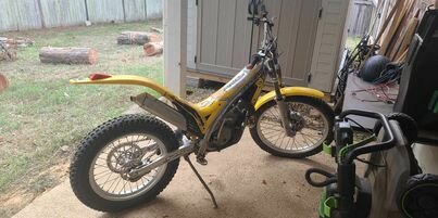

Well Ive been working on the bike getting it going. Gone thru it all and its been running great, did my first ride yesterday for about 20min before it ran out of gas(only mixed a little for testing). That said I knew it would need some revs to get up and over stuff but its pretty crazy. I think I need to make a few clutch adjustments or need to bleed it a little better(had a dry master when I got it). Anyway heres a little before and after(not the greatest after pic but it looks 10x better than when it showed up needing a lot love). Only have about $1800 into it so far and dont see it needing anything major for the time being.

Dry clutch master means the DOT fluid or mineral oil has leaked past the piston O-ring and into the transmission, its an easy fix but you need to use the right size and material type replacements.
The bike was sitting for 6yrs in TX so it was actually dried out. I flushed the system, inspected seals and refilled, its DOT fluid as its 03. Its been a few weeks since that issue was addressed and hasnt lost any fluid since.

Almost guarantee the fluid leaked down through the O-ring, only way it could evaporate to that extent is if you left the reservoir cap and rubber diaphragm off.  The purpose of the rubber diaphragm is to reduce water from contacting the hygroscopic DOT fluid.  Moisture on top of the diaphragm is water that has entered through the tiny vent hole and condensed.  Vent hole needs to be clear or lower fluid level will create a vacuum in the reservoir.
Maybe the case but the 6yrs sitting would allow either issue to empty it(Ive seen both happen on other bikes). I'll just keep an eye on it and rebuild it if it has trouble holding pressure or constantly leaks down.
