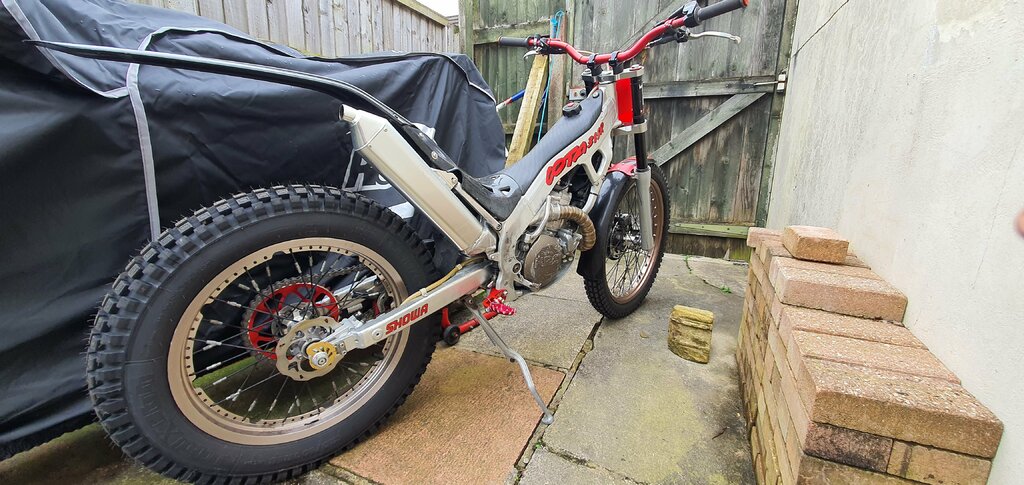

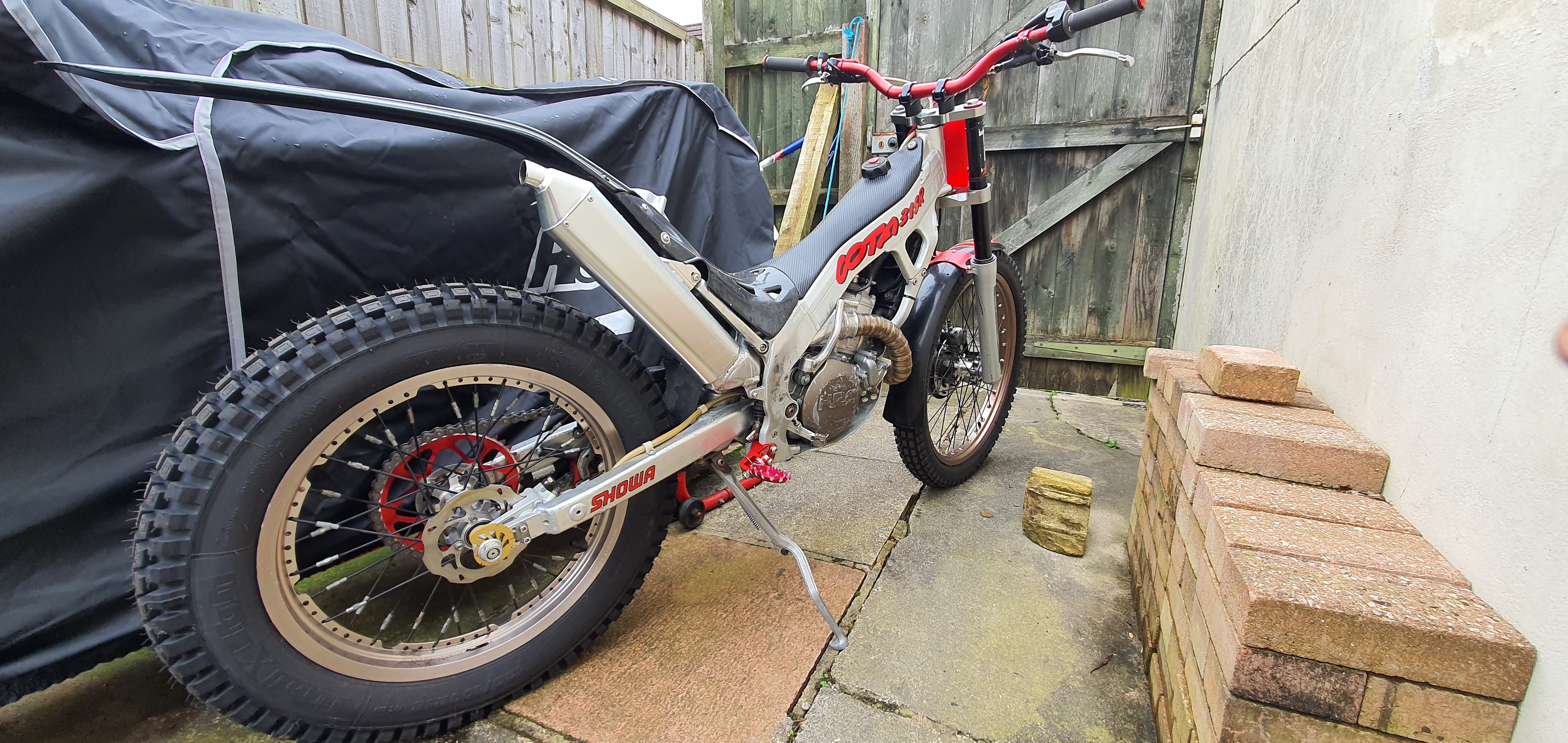

This is a Jotagas rear wheel with a later model rear caliper in the 'wrong' bike.
It just took a load of measurements, home made spacers, a touch of filing and it lined up nicely.
The front forks and clamps are 40mm Marzocchi from a Gas Gas. Stuff will generally fit but it takes a bit of searching for the measured part you think will fit, such as alternative bearings and spacers.

NICE BIKE!
Thanks for you answer.  I know post -2000 are a direct fit, and found info about swapping 4rt and 315 rear wheels, but not about the pre 2000 bikes.
I was also thinking about what to do with the rear brake caliper (if it was necessary to replace with the Newer one as you did), but seems that the width is the same and is a direct bolt-in?
