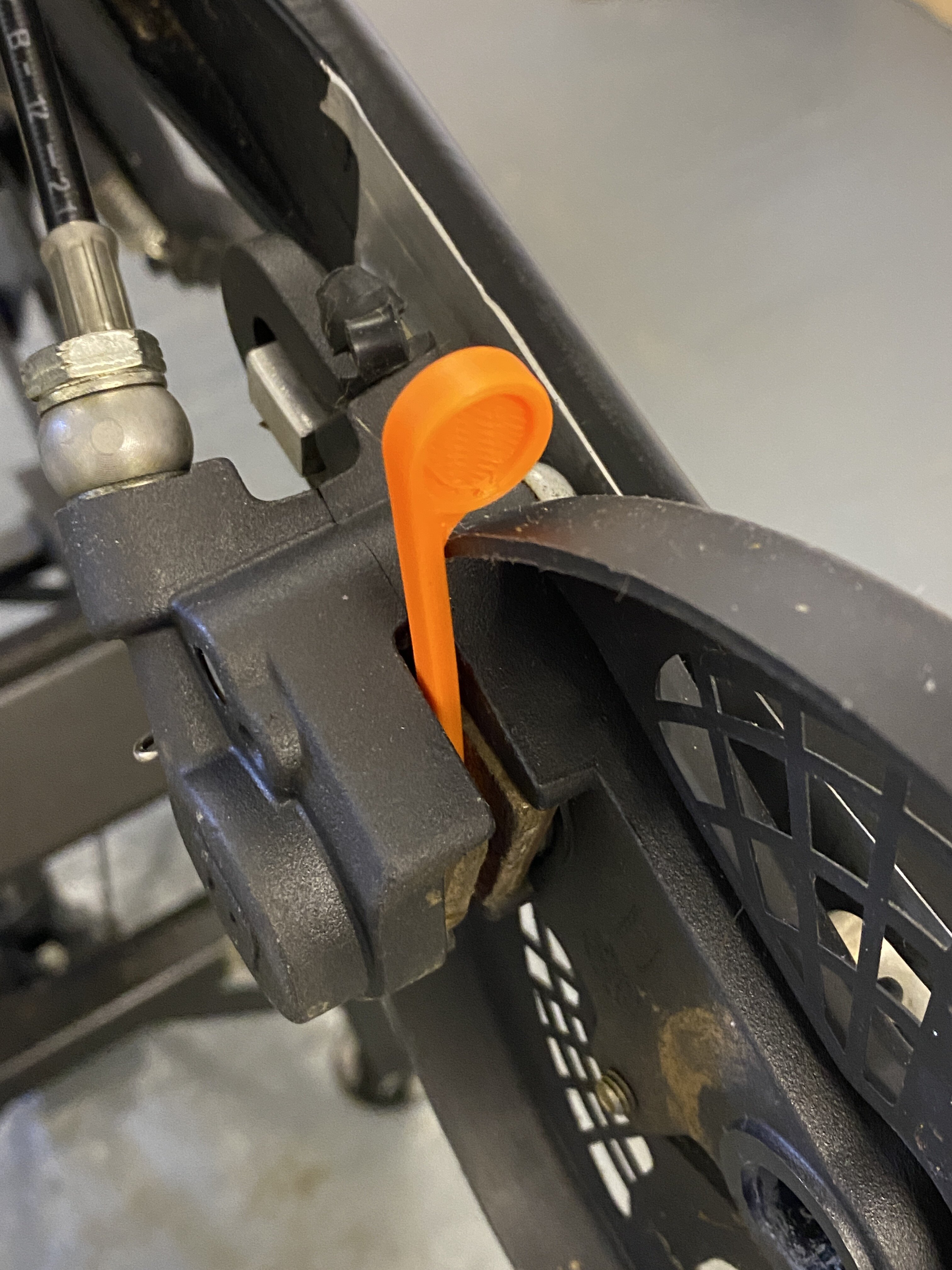

trapezeartist Posted February 12, 2025 Report Share Posted February 12, 2025 I made a tool for holding the rear brake pads apart while fitting the rear wheel. It should work with any brake using a 3mm disc. There are two versions: V1 is the stronger one but needs the printer settings to be tweaked just right to make it a snug fit between the pads. V2 is more tolerant of a slight variation in dimensions but is probably less durable (but if you break it, just print another one). https://www.thingiverse.com/thing:6947125 1 1 Quote Link to comment Share on other sites More sharing options...

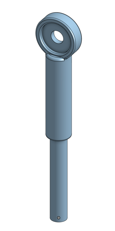

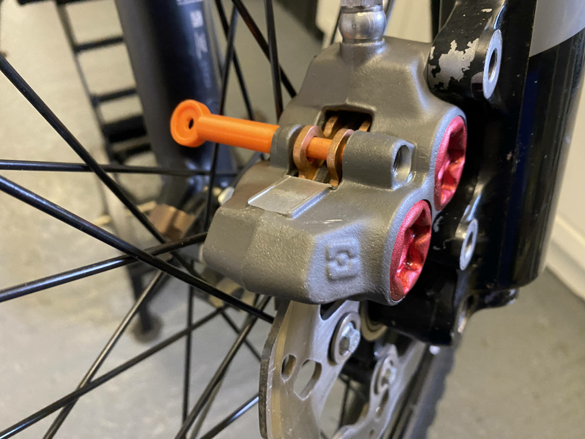

trapezeartist Posted March 13, 2025 Report Share Posted March 13, 2025 Moving on to the front brake, I find it fiddly to install the front brake pads, anti-rattle spring and retaining pin before fitting the calliper to the forks. So I made this guide to hold the pads in place while the calliper is being fitted. Once it's bolted on, insert the retaining pin and push the guide out, tucking the anti-rattle spring in place as it goes. https://www.thingiverse.com/thing:6977705 2 Quote Link to comment Share on other sites More sharing options...

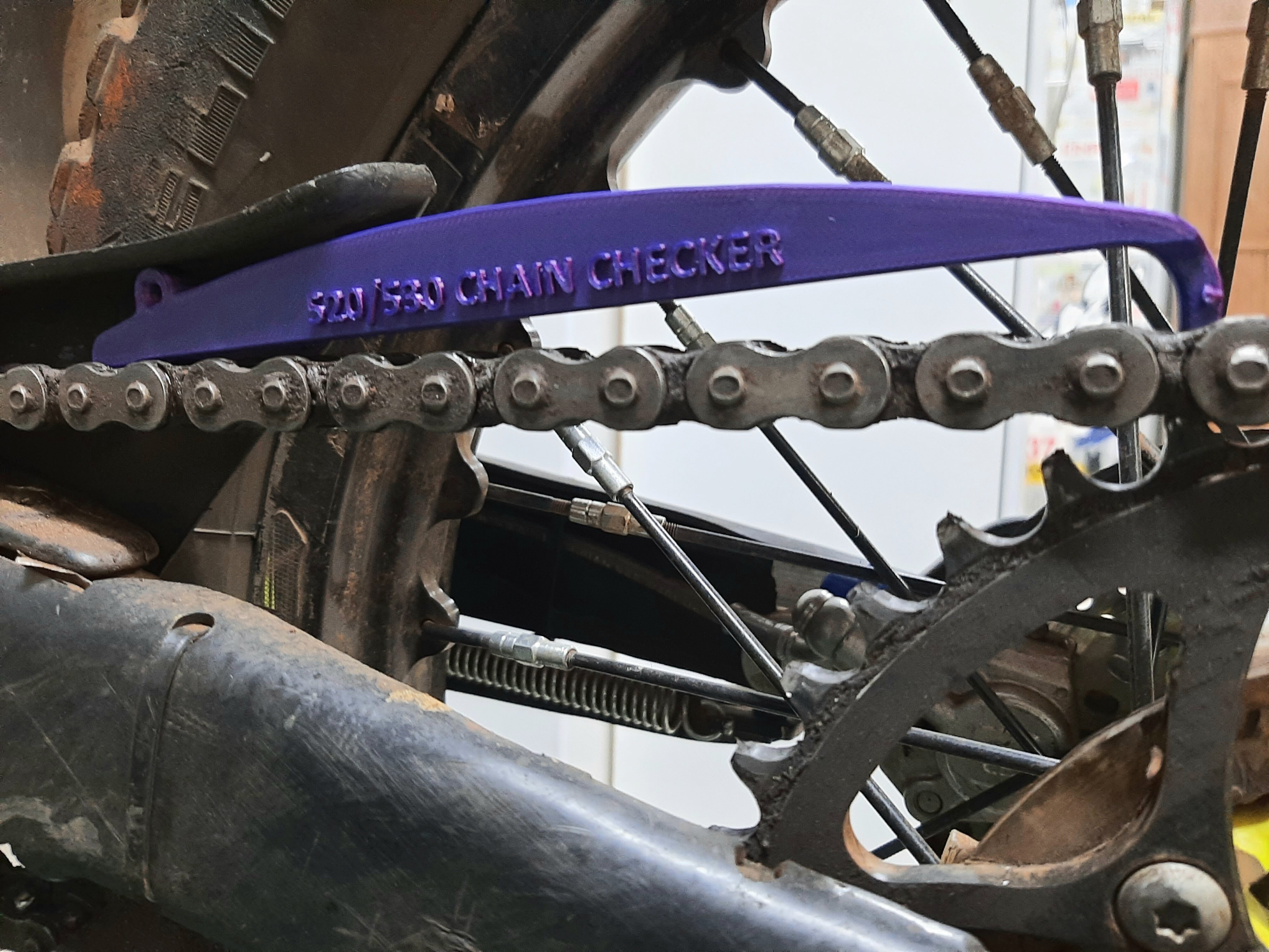

cascao Posted May 19, 2025 Author Report Share Posted May 19, 2025 Chain wear test https://www.thingiverse.com/thing:7042065 Quote Link to comment Share on other sites More sharing options...
