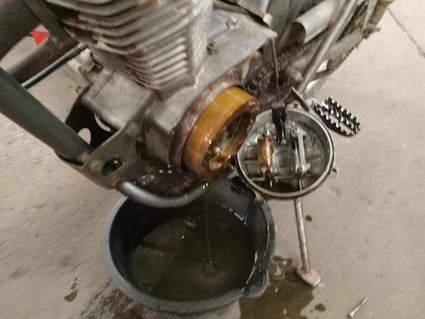

Do yall think someone put extra flywheel weights in there?
the PO said that the folks before him installed a lighting kit and that was the remnants
my book says that the wiring and coils are there for lights SOOO I don't know
Pull the cover off and you might be able to tell, you certainly would not want to ride it like that.  The OEM flywheel should have part numbers stamped on it and you should be able to see the coils attached to the cover.
Here is the thing it is sealed and runs perfectly
So I take it the steel part we see behind the bolts and the paper gasket on one side is a stationary steel spacer ring?
We need to see inside to know what they did in there 👍

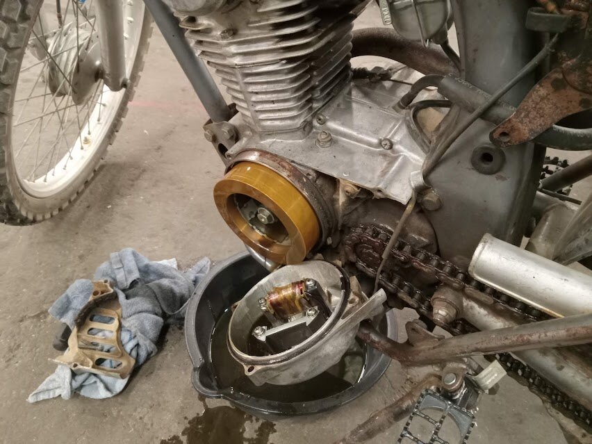

... and only one field coil so they fibbed about the adding lights part.  Extra weight on the crank will lessen the likelihood of a stall but also retards the engines ability to accelerate.  Your riding style is what will determine if the heavy flywheel is a desirable modification or counter productive to your riding, when I rode TY250 I found it advantageous to go the opposite way and lighten the flywheel by removing the factory added weight  ymmv.

I can't change it ( the spacer is pressed into the case) so I will live with it. (I could change to a stock flywheel and leave the spacer intact)
I don't know the difference at the moment, but a buddy had a stock motor in his TL and I can try his in the near future
I don't think top riders' preferences have anything to do with a TL125.  🙂
Personally, I like a lot of flywheel inertia. See: https://www.electricmotiontech.com/home/em-epure-race/my-modifications/adding-flywheel-inertia
The best test would be to borrow your buddy's flywheel and install it on your bike. That way, any other differences won't complicate the evaluation.
P.S. I'll bet that steel spacer is more corroded into the case than pressed.  Aluminum has a greater coefficient of thermal expansion than steel, so a little heat will probably loosen it.
