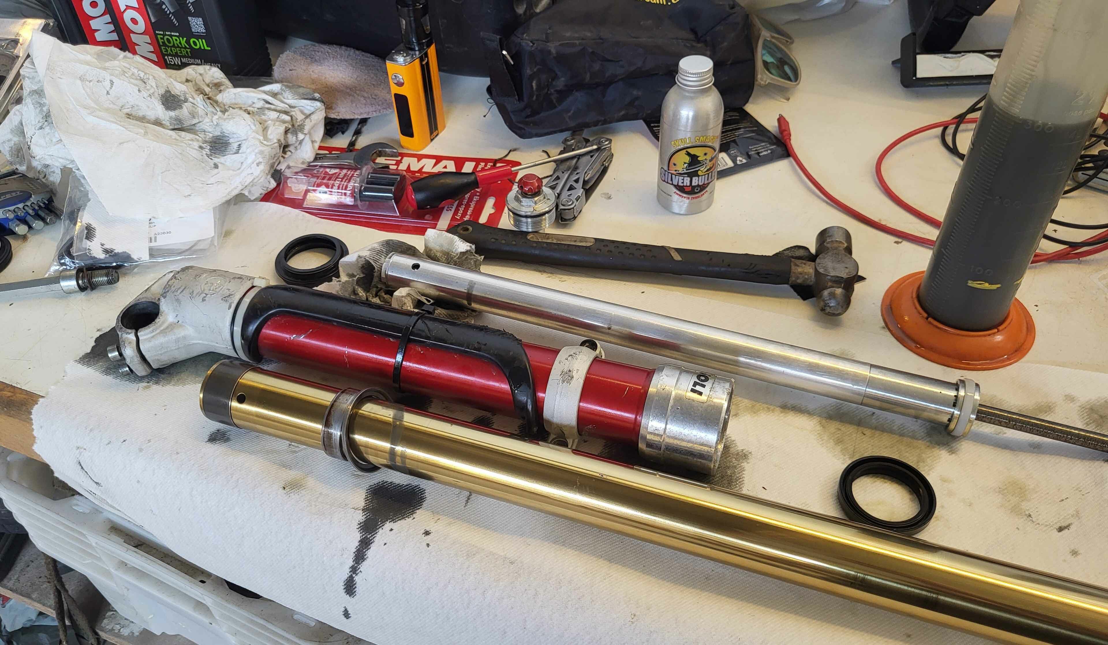

Beginner rider with six months of riding under my belt here. I'm a heavy dude (currently 140kg, actually using the bike to lose weight) and put 10wt oil in the forks of my Beta when I first got it and got new, heavier springs for it.
I'm in the midst of a fork seal change right now and the oil already looks ready to change, so I figured I'd do that as well - would you recommend I go back down to 5wt oil, or maybe 7.5wt? I'm frankly a bit clueless when it comes to the finer points of suspension, but I have noticed experienced riders can nearly bottom out their forks just lightly hopping in place. Mine seems a lot firmer, and it's a touch difficult to get the front up. Maybe the lighter oil is what I need?
Also, in case anyone knows: apparently the 38mm Paioli fork has a separate part that holds the fork seals in place - Is it just held on by the little clip on the fork leg and the force of the seal gripping it? It seems a bit strange, just wondering if I'm missing anything. Maybe I'm supposed to take it off, attach the seal first and then put it on? I couldn't quite get it in there doing it the conventional way today, before I got pulled away from the workbench.

Good info, thanks. The Beta fork seems slightly different in that it has a little flange where the seal ring mounts, and the fork brace doesn't slide up far enough to clamp the ring all the way up... Currently attempting to simply clamp the ring in a vice, but the seal doesn't want to go in all the way? The bushing is fully seated, but the seals just won't go in straight. I'm using a tool I cobbled together from PVC pipe, but am now considering ringing up the local bike shop to whack them in place for me.

Thanks for the advice, and I'll keep it all in mind next time I do fork work, but as stated, the 10wt oil was freshly changed by me when I got the bike six months ago. The Techno manual I found online recommends 360cc 5wt oil both legs, as does Jim in the video posted above, so I went with that. Let's be honest, most of the discoloration is probably from leftover oil from me not fully disassembling the forks the first time...
The local bike shop treated me well, they bashed the seals in for me for a pack of coffee and some cinnamon buns. They were absolutely baffled by the separate seal holder doohickey, even the older dude with four decades of experience had never seen anything like it :D
She's all back together now, and from some hopping around at work, she's *much* more lively and I can indeed compress the front quite far with a decent stomp on the pegs. Looking forward to trying it out on the hills on my day off.
