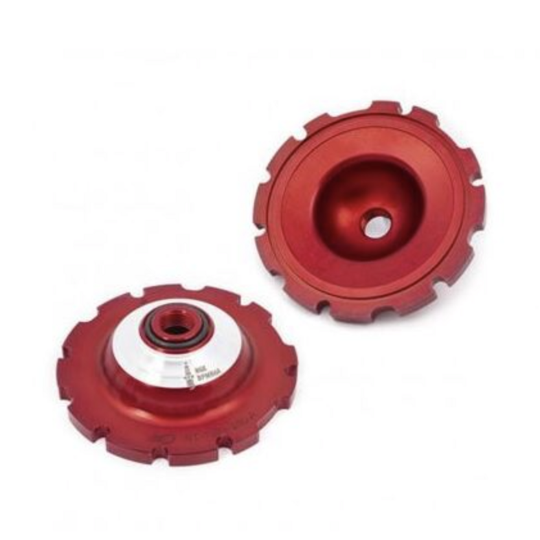

scorpaian Posted January 29, 2025 Report Share Posted January 29, 2025 (edited) Can anyone advise me what plug is needed for a 300RR fitted with S3 low compression head? A moment it has an ngk bp6 stand long reach plug, is this because of the head insert? The correct plug I seem to keep seeing is a small short reach bpmr6a? Any give me correct info? TIA Edited January 29, 2025 by scorpaian Quote Link to comment Share on other sites More sharing options...

scorpaian Posted January 29, 2025 Author Report Share Posted January 29, 2025 So looking at S3 website, the pics show the neck of insert where I screw in plug a lot shorter than the one I have? Was this a mistake? or just altered and I have an older model insert? So basically, the normal bike should have a small short reach plug, but as my plug head insert is longer it's had to use a normal tall plug?? Only way to use standard short plug is to turn head insert down? Quote Link to comment Share on other sites More sharing options...

scorpaian Posted January 29, 2025 Author Report Share Posted January 29, 2025 Dude, you've missed the point, forget the plugs at mo, it's the insert I'm asking about, I have two short plugs (seems correct small ones) but the one in it is a long reach, why? is my insert different or incorrectly made? Anyone have an answer, I think Konrad seems to get it, but still not overly clear! 1 Quote Link to comment Share on other sites More sharing options...

Tr1AL Posted January 29, 2025 Report Share Posted January 29, 2025 (edited) 1 hour ago, scorpaian said: Dude, you've missed the point, forget the plugs at mo, it's the insert I'm asking about, I have two short plugs (seems correct small ones) but the one in it is a long reach, why? is my insert different or incorrectly made? Anyone have an answer, I think Konrad seems to get it, but still not overly clear! If you click on the picture that konrad put in his reply all the information you require is in the post put up by a member using the name jer with splat shops on line shop selling the S3 head inserts. Edited January 29, 2025 by Tr1AL 1 Quote Link to comment Share on other sites More sharing options...

scorpaian Posted January 29, 2025 Author Report Share Posted January 29, 2025 Yes I've seen the splatshop description, it's very confusing but I get it now, basically I need to buy long reach NGK BP6RES plugs!! Quote Link to comment Share on other sites More sharing options...
arnoux Posted January 29, 2025 Report Share Posted January 29, 2025 (edited) There is an S3 low plug type that takes the BPMR6A plug (stock plug) and fits the standard TRS head cover. https://www.thehellteam.com/trs-cylinder-head-insert Edited January 29, 2025 by arnoux Quote Link to comment Share on other sites More sharing options...

arnoux Posted January 29, 2025 Report Share Posted January 29, 2025 26 minutes ago, scorpaian said: Dude, you've missed the point, forget the plugs at mo, it's the insert I'm asking about, I have two short plugs (seems correct small ones) but the one in it is a long reach, why? is my insert different or incorrectly made? Anyone have an answer, I think Konrad seems to get it, but still not overly clear! S3 make two different high comp 300 inserts. One is for fitting a short BPMR6A plug as found on RR, R and ONE models, and one that takes the BPR5ES longer plug that is fitted to the GOLD model. Quote Link to comment Share on other sites More sharing options...
arnoux Posted January 29, 2025 Report Share Posted January 29, 2025 3 minutes ago, scorpaian said: is this lower comp? NO. S3 colour code their inserts: Yellow / Gold = Low Compression Silver / raw aluminium finish = stock compression Red is always the hi Comp variant. Quote Link to comment Share on other sites More sharing options...
