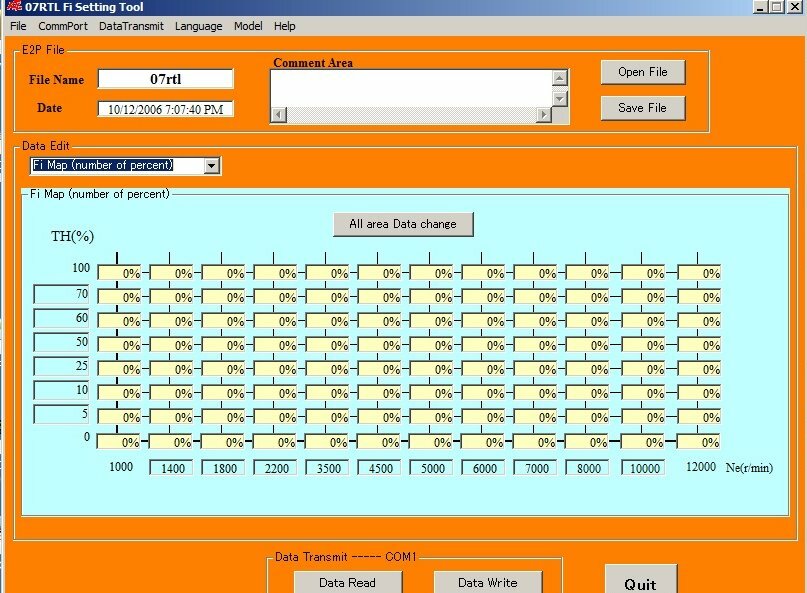

konrad Posted May 13, 2025 Report Share Posted May 13, 2025 On 5/11/2025 at 10:22 AM, mcman56 said: Can the 4RT be tuned to respond more like the Beta? It does have the black throttle tube. I sort of remember options for early models that allowed the owners to tune or maybe load different maps. I'm not finding anything online so is anything like that still available? A friend loaned me an old Honda "Setting Tool" so I could learn about it. Here is a bit from my notes: The computer interface requires an RS-232 port. Newer versions work with a USB port. The ECU interface uses the K-Line protocol, which is primitive automotive standard from the early days of OBD2. The Setting Tool software requires a 32-bit OS. I tried enabling 32-bit apps under Windows 10, but this did not allow the program to run. The actual EFI map is not accessible, only modifications to it. The modification matrix has 8 default throttle positions (0, 5, 10, 25, 50, 60, 70, and 100%) by 12 RPM positions (1000, 1400, 1800, 2200, 3500, 4500, 5000, 6000, 7000, 8000, 10000, and 12000 RPM) for both fueling and ignition timing. Each of the default throttle and RPM positions may also be changed slightly, for example 1400 rpm has a range of 1100 to 1700. You are not permitted to move the value into an adjacent range bin. I was also given a half dozen example modification files. Remember they are not actually maps themselves. This is really nice because they could be applied to any year or displacement Montesa trials bike. The only "incompatibility" seems to be if the file is for a single or dual map throttle body. But that changed in 2007, and all bikes going forward seem to have dual map capability. (Well not really, as Montesa made some bikes homologated for road use that don't allow any reprogramming at all.) Fueling: +/- 30% change in 1% increments. A total of 61 values. Ignition Timing: +4 degrees to -12 degrees change in 1 degree increments. A total of 17 values. You can specify whether changes apply to "mode 1" or "mode 2" (map switch), but the default is both modes. The modification files have an .ep2 extension. They are written in Intel Hex format and are quite compact (~750 bytes). Each file has an area at the end to write comments in ASCII text. Quote Link to comment Share on other sites More sharing options...
mcman56 Posted May 15, 2025 Author Report Share Posted May 15, 2025 Is the tool still available? I don't see anything in the 2018 300RR parts list or service manual. Searching online, I get no clear answer. Although, I see one for a CFR250 is pretty expensive so hard to justify https://www.rockymountainatvmc.com/parts/honda-pgm-fi-setting-tool-p?srsltid=AfmBOoriVL_t6J6WD2_uqMxRoEZDE-ZnbgTGCmcIl9nImw-E11jsmHkL Quote Link to comment Share on other sites More sharing options...
