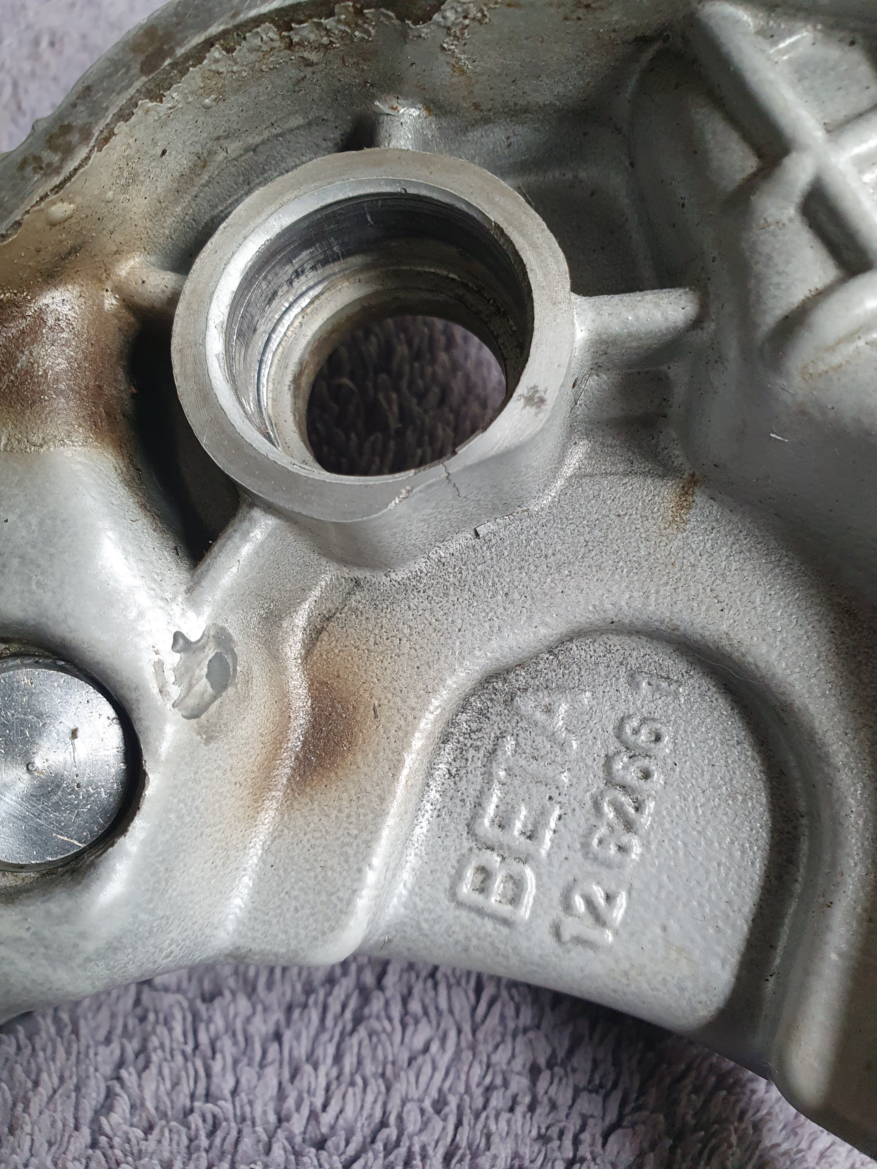

cello Posted June 8, 2025 Author Report Share Posted June 8, 2025 Thanks i will look to sort thebrake next.......that is after i have fixed the next issue! I now have noticed a hair line crack in the casing onthe inside of the case where the water pump bearings sit , not sure if tryi g to press a new bearing in would cause more damage and if i should have this welded , use jb weld or just give the new bearings a go ....any advice inmates? Quote Link to comment Share on other sites More sharing options...
cello Posted June 8, 2025 Author Report Share Posted June 8, 2025 Ceack radiates onto the face the bearing presses into 😩 Quote Link to comment Share on other sites More sharing options...
konrad Posted June 8, 2025 Report Share Posted June 8, 2025 (edited) If you weld it, the bore will have to be re-machined. That's a reasonable place for JB Weld, but after the bearing is installed. Don't press the bearing in, heat the case and cool the bearing so it is a clearance fit and drops in. I've written a bit about bearing fits and CTE which may be helpful: https://www.ossa-efi.com/home/engine/gearbox/locker-shaft#h.3t5em1loxmz9 EDIT: looking at the photo again, Beta thinned the casting section where it is cracked. This would be stupid to do if not necessary. So, another part must be in close proximity. This complicates things. Edited June 8, 2025 by konrad Quote Link to comment Share on other sites More sharing options...
Tr1AL Posted June 8, 2025 Report Share Posted June 8, 2025 (edited) @ cello RE that crack , to worry or not to worry that is the question I have had motors that had the same near a bearing housing and just left them like that fitted a new bearing and nothing bad happened. If you follow konrads advice and freeze the bearing over night before heating the casing you won't risk making it worse. Unless you are going to weld it and machine it yourself or know some one who can it will get expensive and you may as well look to buy a complete gearbox and casings off ebay etc to get a lot more for your money. If the bearing outer race turns in the housing just use a liquid bearing retainer adhesive such as Loctite 641. Regards Alan. Edited June 8, 2025 by Tr1AL Quote Link to comment Share on other sites More sharing options...
cello Posted June 9, 2025 Author Report Share Posted June 9, 2025 thanks for the advice both of you, I did what you said and dropped the bearings in , a sharp tap with the hammer and they seated ok with no apparent woresning of the crack. I have also applied a layer of JB Weld just to ease my mind a little and will give it a try. Can someone confirm the orientation of the waterpump seal , the one I removed had the closed side towards the water with the open side towards the oil - is this correct? Quote Link to comment Share on other sites More sharing options...

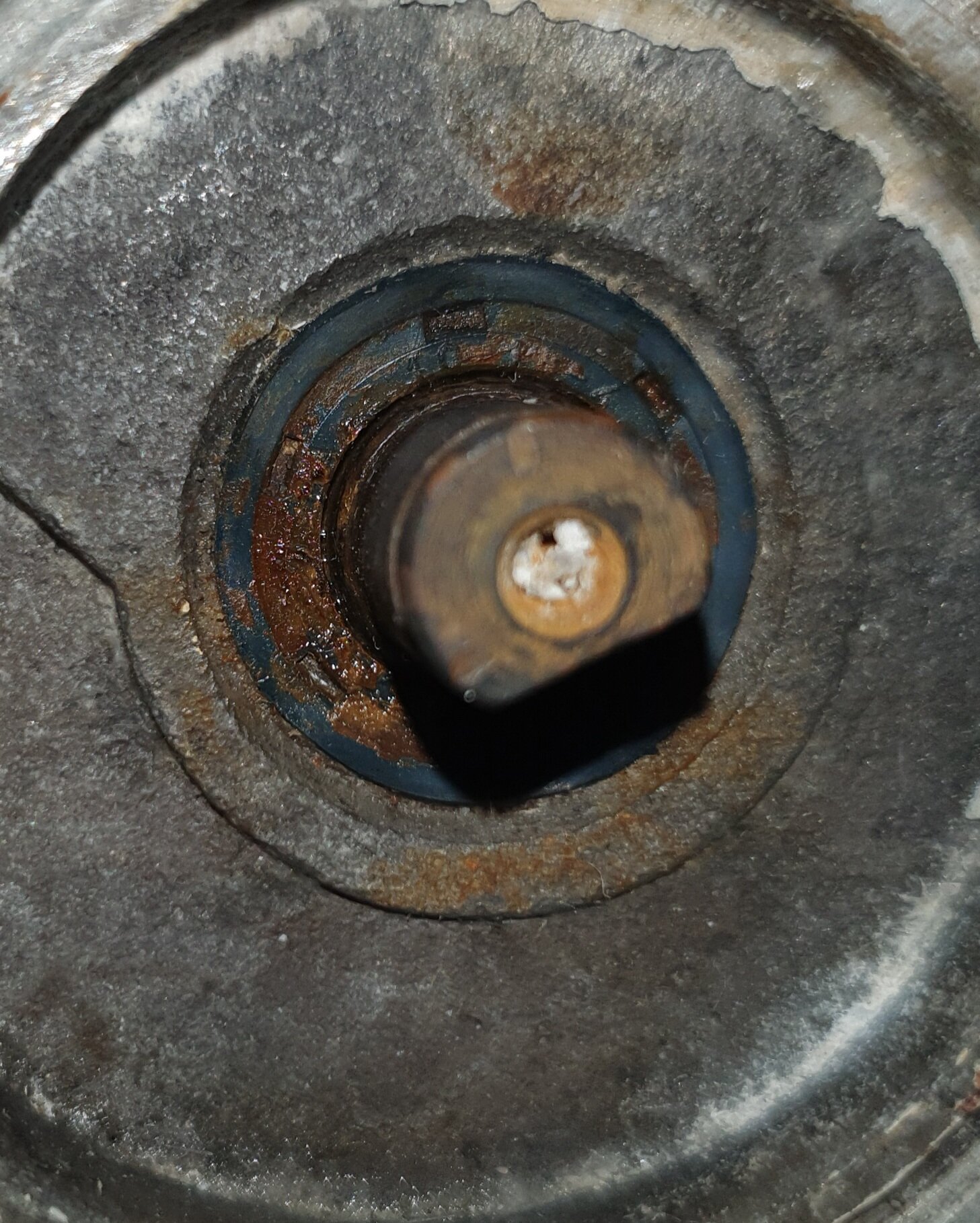

cello Posted June 9, 2025 Author Report Share Posted June 9, 2025 Thank you, so the last owner fitted the seal incorrectly - see pic Quote Link to comment Share on other sites More sharing options...
Tr1AL Posted June 9, 2025 Report Share Posted June 9, 2025 (edited) 1 hour ago, cello said: Thank you, so the last owner fitted the seal incorrectly - see pic @ cello the World is a strange place BETA probably fitted them like that at the factory , the seal will work like that and probably cause no problems but the seal for the pump should really have a seal that has the open end with the expansion spring near the lip facing toward the coolant , the pressure of the coolant goes against that area thus helping it to seal more than without any pressure. If you check out the TRS trials bike it has a seal for the oil and a seal for the coolant with a gap between the two seals that is within a casing and that casing has a hole, if the pump seal fails coolant drips into the casing and out of the hole so that you will know it has failed .On the TRS the seal for the oil has the open end facing the oil and the seal on the pump has the open end facing the coolant as they should. Regards Alan. Edited June 9, 2025 by Tr1AL Quote Link to comment Share on other sites More sharing options...
cello Posted June 29, 2025 Author Report Share Posted June 29, 2025 Thanks seal in and looking good so far , I wonder if the seal is this way round because the garter spring in the seal is not made of stainless-steel and hence would suffer from corrosion and ultimately fail. 1 Quote Link to comment Share on other sites More sharing options...
