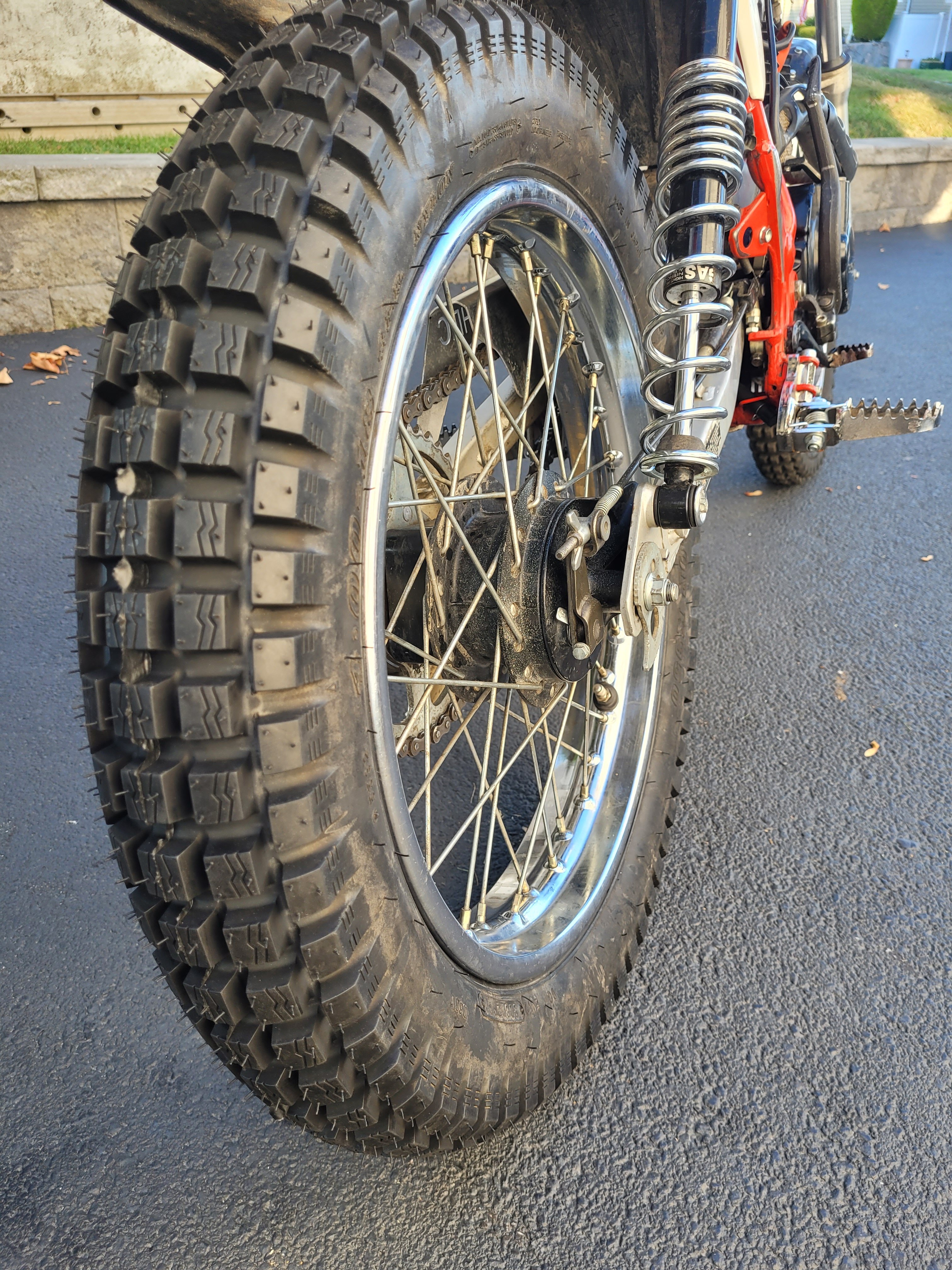

lemur Posted June 13 Report Share Posted June 13 Now I gotta put something on the rear so I have a spare bike again 😎 1 Quote Link to comment Share on other sites More sharing options...

lemur Posted June 16 Report Share Posted June 16 (edited) OMG people his tube type steel rim isn't even a safety rim, you know those tools called a bead break? <- he does not need one because the tire will never bead. You know the big Bang that a tire makes at the tire shop when the tire mounts the bead <- his tube tire on plain ol steel rim will never make that noise unless he has a blowout, because there is no bead to seat 😐 stop making it more complicated, the Only way that tire won't slide right into place Dry is if he pinches the tube between the tire and rim when he is mounting it. Edited June 16 by lemur Quote Link to comment Share on other sites More sharing options...
johnnyjazz Posted October 7 Author Report Share Posted October 7 Apologies for not closing this out sooner! Thank you all for help, it was pretty easy as you said it would be! definitely helped me grow in confidence as its another thing Ive now learnt to do. The hardest part was trying to get the valve stem back through the hole! Appreciate you all.... now to the anti judder clutch kit.... lol 1 Quote Link to comment Share on other sites More sharing options...
