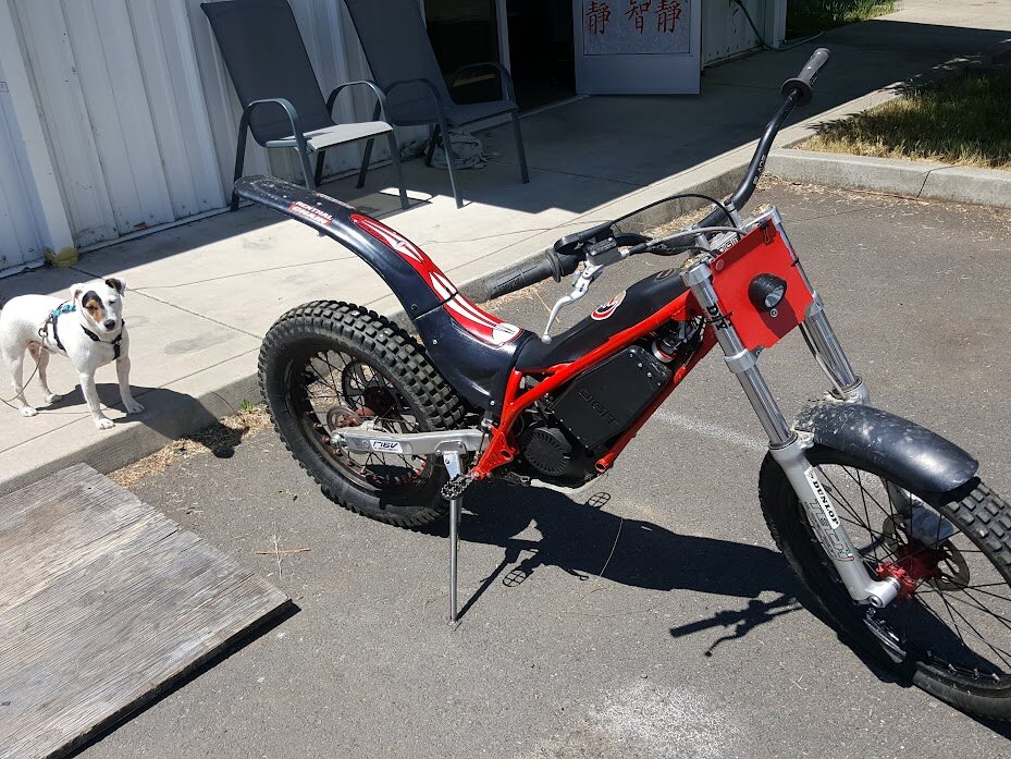

nostroke Posted July 26, 2025 Report Share Posted July 26, 2025 I'm curious about some of the programming used on these bikes. I just got a 2024 pure sport with diaphragm clutch and the 3 mode settings. But I'm used to a bike I built and posted here years ago that uses a Perm brushed motor and an Alltrax 48V 400 amp controller. I am comparing the EM throttle response and general feel to my old 'Digit' I built. The Digit, because its a brushed motor, is by nature always in speed mode, so throttle command is proportional to the motor rpm as opposed to most brushless motors that typically (the EM) operate in torque mode where the throttle command is proportional to the current. My Digit does not have a clutch but throttle response is very crisp and both splats and wheelies are very predictable and easy to control. The EM however feels really mushy response-wise and its harder for me to control since I'm used to speed mode modulation. Has anyone programmed an EM to operate in speed mode? I also build street and road race electric bikes and have done so for many years (I'm old). On street bikes, torque mode is more intuitive but for off road use and on my EM, I think that speed mode would be better. Anyone know what I'm babbling about? Quote Link to comment Share on other sites More sharing options...

nostroke Posted July 26, 2025 Report Share Posted July 26, 2025 (edited) Is it likely that the controller is available direct from siliXcon unprogrammed? Also, I should add that the Perm/ Alltrax package I used, while pretty crude by today's standards, does not use a feedback device although a brushless could emulate that with its feed back loop I suppose. I'm not a EE but have dabbled with EV controls forever. Edited July 26, 2025 by nostroke Quote Link to comment Share on other sites More sharing options...
