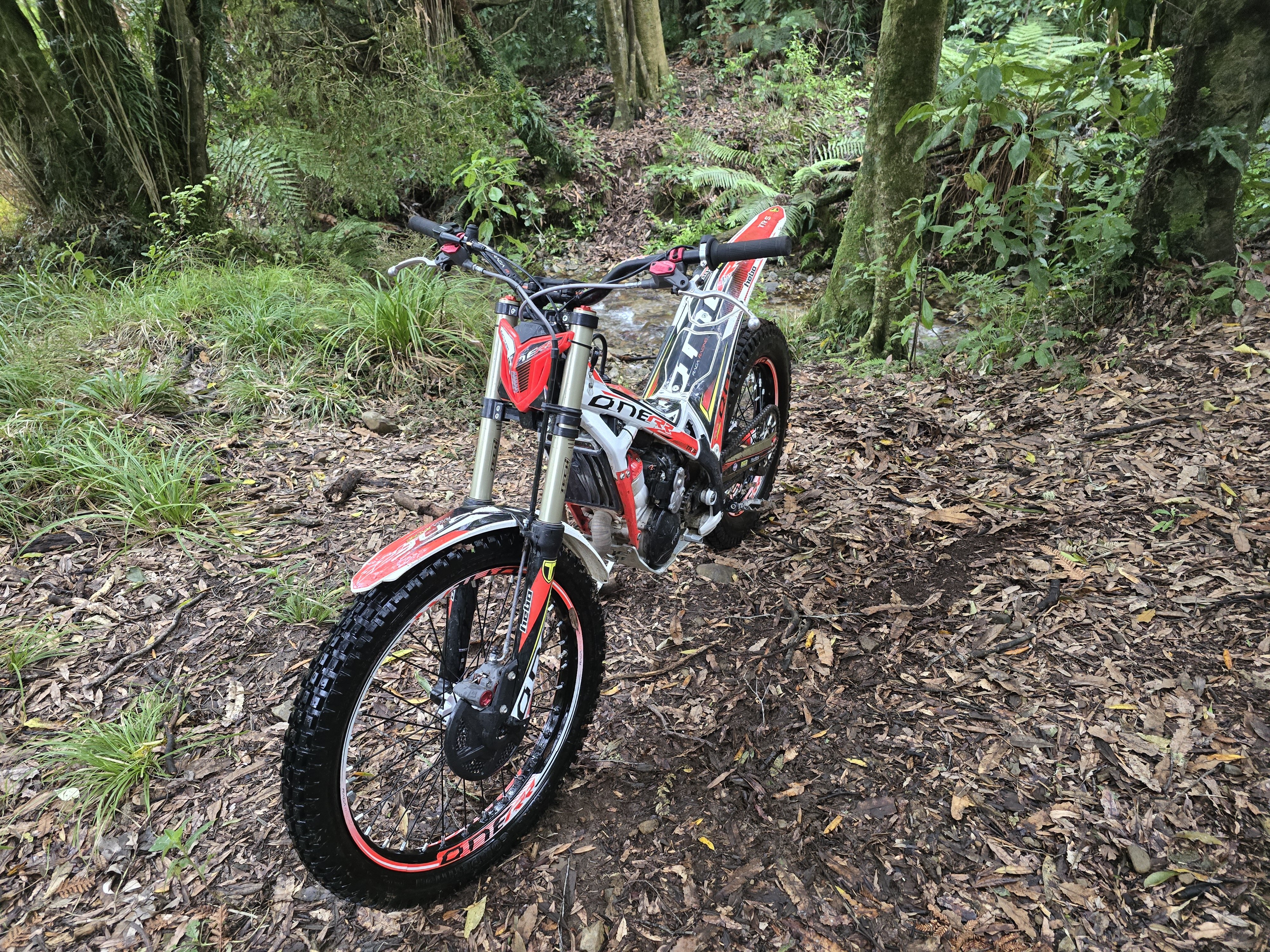

F5Dave Posted October 5 Report Share Posted October 5 (edited) As title. You can supposedly get a H, M, Or S support ring.. This apparently gives a softer, well if you choose S over M which is standard. I also put GRO Rockoil 75 in. There's f all difference in the support rings. But, well maybe I can tell the difference. I've only ridden up the driveway a few times and then in circles for a few minutes. Actually it does feel easier. My GG250 did seem more progressive . After a horrendous medical event I have been left clumsy and unbalanced. My GG would have been easier to come with..Jebuz, I'm lucky to be walking. But 2 years on if can ride my trials bike. But I am bouncing off stuff. Hence the softer ring. So more updates when I actually get to ride off road properly. Edited October 5 by F5Dave Quote Link to comment Share on other sites More sharing options...

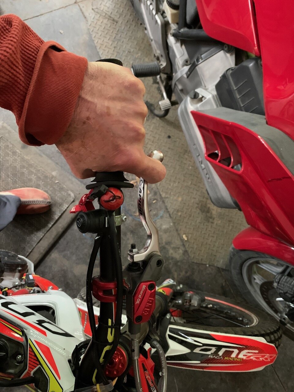

lemur Posted October 6 Report Share Posted October 6 Shorty levers moved way in on the bars, slack adjusted to provide comfortable bend and range for the clutch finger, gives you the most leverage and friction range possible and your lever will never crush your grip fingers 👍 3rd gear pulls from zero to biggest thing I can ride so I ride almost exclusively in 3rd but that really depends on the terrain you ride. 1 Quote Link to comment Share on other sites More sharing options...
F5Dave Posted October 6 Author Report Share Posted October 6 Sadly my index finger doesn't have the power or another joint so I've had to start riding with my middle finger doing the work. Nice moccasins. My electric button is on the right. Any reason for the left? Quote Link to comment Share on other sites More sharing options...
lemur Posted October 7 Report Share Posted October 7 15 hours ago, F5Dave said: ... My electric button is on the right. Any reason for the left? Switched the starter button to the left side because for me it makes it much easier to restart without loss of control over the throttle and clutch. Quote Link to comment Share on other sites More sharing options...
