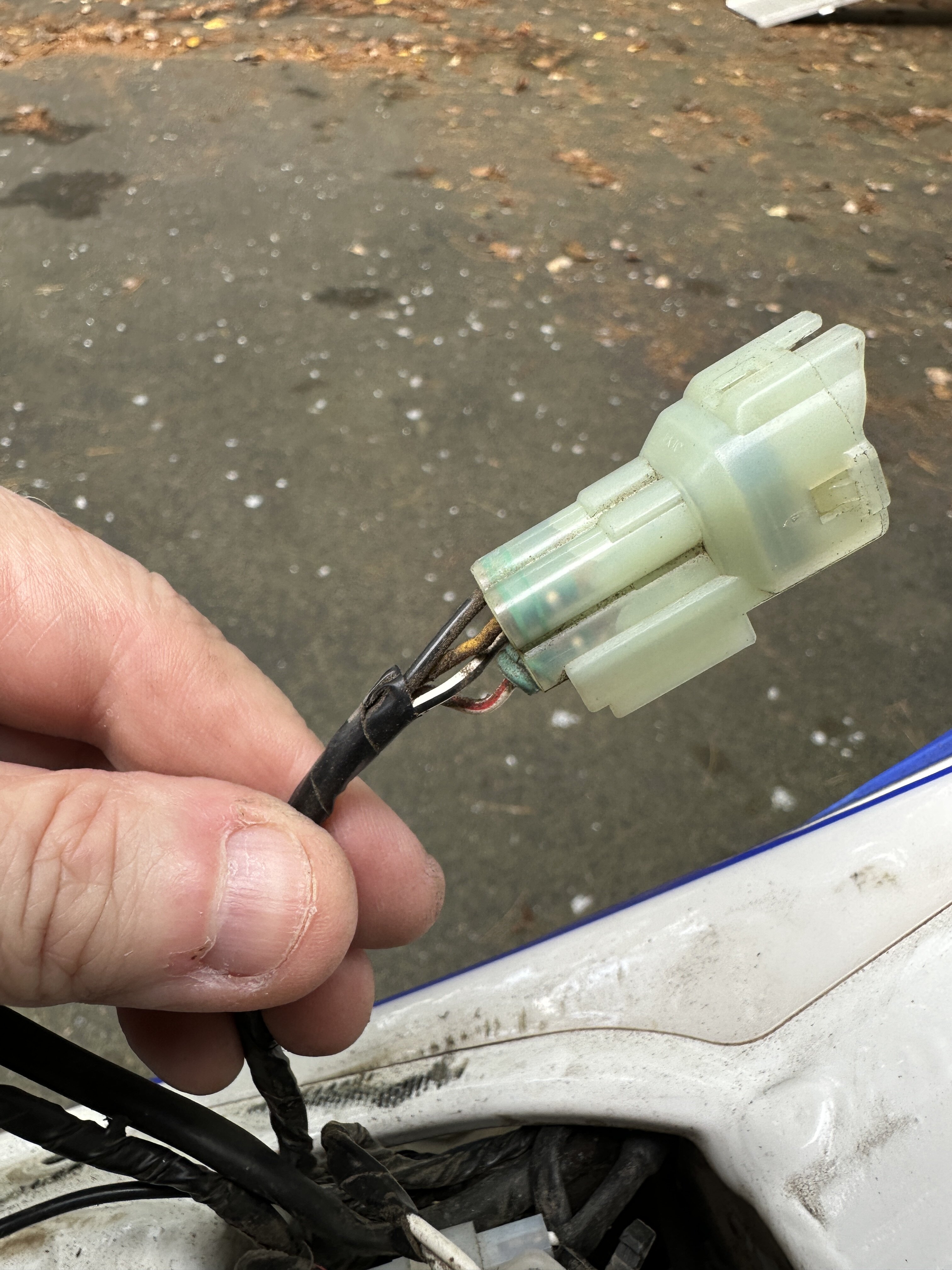

dan williams Posted October 22, 2025 Author Report Share Posted October 22, 2025 Hmmm looking at closeups of the other connector and I noticed the water seal on the back of the high voltage wire (Red/White) to the coil looks less than perfect. Quote Link to comment Share on other sites More sharing options...

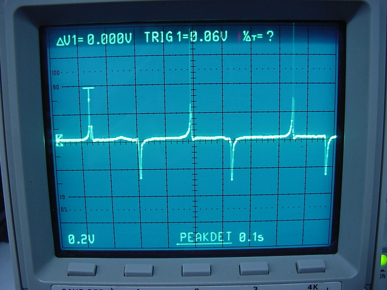

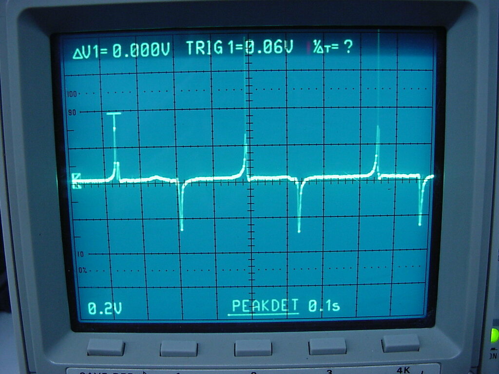

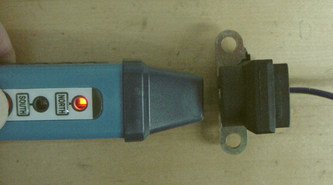

konrad Posted October 22, 2025 Report Share Posted October 22, 2025 (edited) Dan, I can add some detail about variable-reluctance pickups. The one shown here is from a Chinese pitbike, but it's representative of what's commonly used. The coil has a DC resistance of 145 ohms. Inductance is 63 mH in air. Inductance is 61 mH when contacting steel. (Both measured at 1 kHz.) The magnet has its North pole facing out. The oscilloscope capture shows the waveform when a block of steel is repeatedly brought into contact with the pickup magnet and withdrawn (by hand). Each positive pulse is contact, each negative pulse is the withdrawal. The waveform is asymmetric because the rate of change in the magnetic flux is faster when making contact (magnet pulls on the steel) than when moving the steel away. EDIT: Just noticed that the scope probe I used did not automatically change the display settings. So the vertical axis is 2 volts per division, not 0.2V per division. Edited October 23, 2025 by konrad Quote Link to comment Share on other sites More sharing options...
