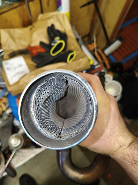

motopsycho87 Posted November 11 Report Share Posted November 11 (edited) Hi all, has anybody removed the baffle from their modern 2 stroke trials expansion chamber? Seems a bit odd as it's the worst place for trapping unburned fuel/oil mix, and kinda negates the point of an expansion chamber in the first place? Edited November 11 by motopsycho87 Picture added Quote Link to comment Share on other sites More sharing options...

jonnyc21 Posted November 13 Report Share Posted November 13 Well unless you want to let out all of the packing behind that baffle I wouldn't recommend it. I can't say for sure on the beta but all of the 2T bikes I have worked on have behind the baffle is one of a few different kinds of packing... Video of an older Sherco getting a re-pack. Quote Link to comment Share on other sites More sharing options...
motopsycho87 Posted November 14 Author Report Share Posted November 14 I managed to rip it out, turns out the baffle tube is titanium just like the outer. Took about 4 hours of hammer, lever bar and brute force. NOT FOR THE FAINT HEARTED! I repacked the silencer while I was at it. Started the bike up in the shed and very crisp note, slightly louder. I'm interested to see what it rides like potentially utilising the expansion chamber shape for the first time ever...! Quote Link to comment Share on other sites More sharing options...
cascao Posted November 14 Report Share Posted November 14 It is a chamber but will never be an expansion chamber like we found on enduro motorcycles simply because the shape and position is not right. Quote Link to comment Share on other sites More sharing options...
