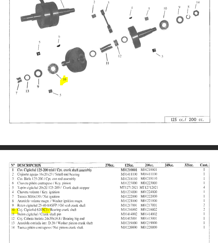

arnoux Posted December 2 Report Share Posted December 2 Hey Chappo, If you look in the original parts manual from GasGas it states C3 for the bearing. 1 Quote Link to comment Share on other sites More sharing options...
