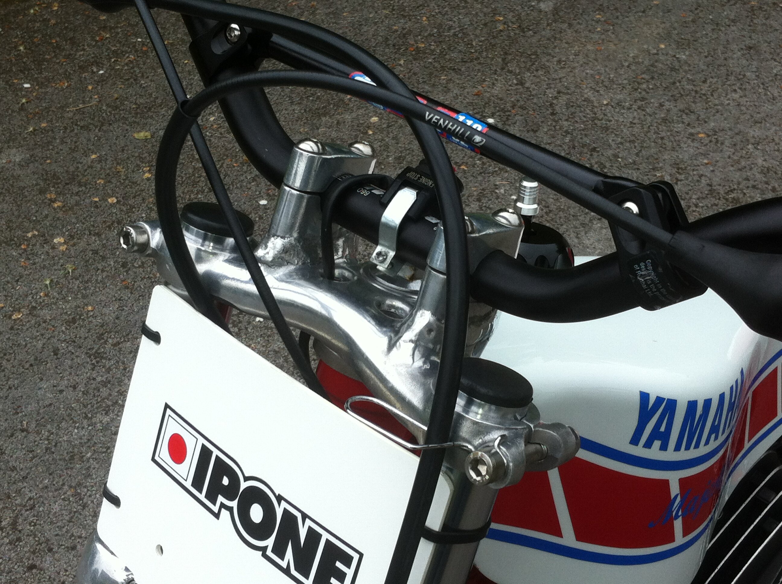

majesty Posted December 31, 2025 Report Share Posted December 31, 2025 (edited) I got my Majesty to steer better by moving the bottom clamps and rewelding : Edited December 31, 2025 by majesty Quote Link to comment Share on other sites More sharing options...
