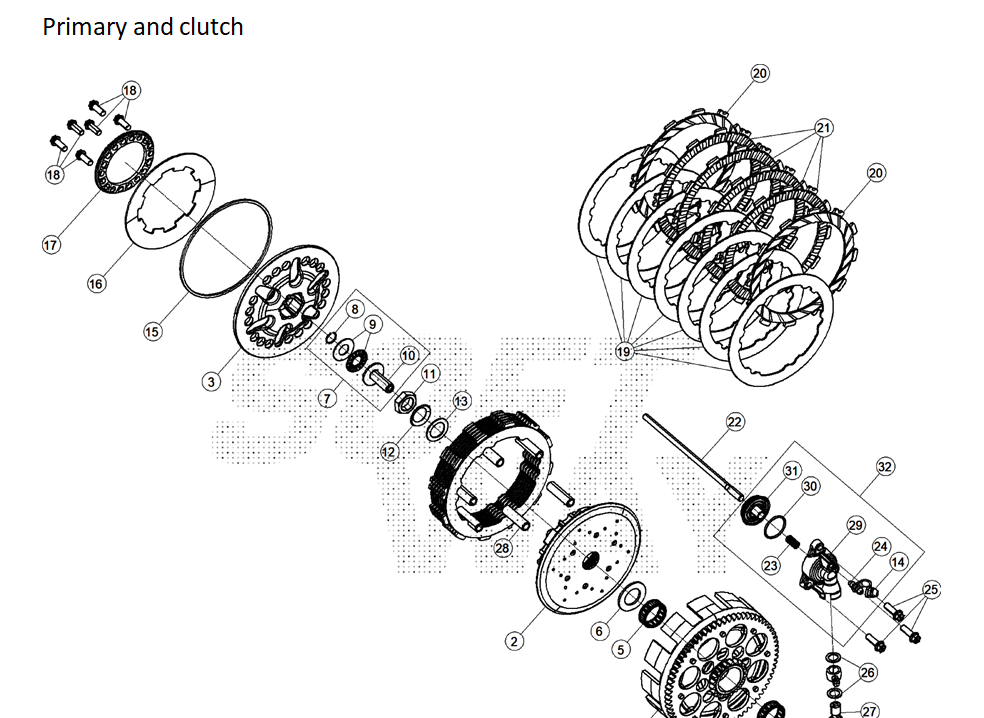

trevbul1 Posted January 22 Report Share Posted January 22 Hi, Delighted with my new 250 Sincro but the factory website says there are three variables for the clutch spring tension but no info on how to change them. Has anybody tried it out yet before I take the clutch cover off? Thanks in advance! Quote Link to comment Share on other sites More sharing options...

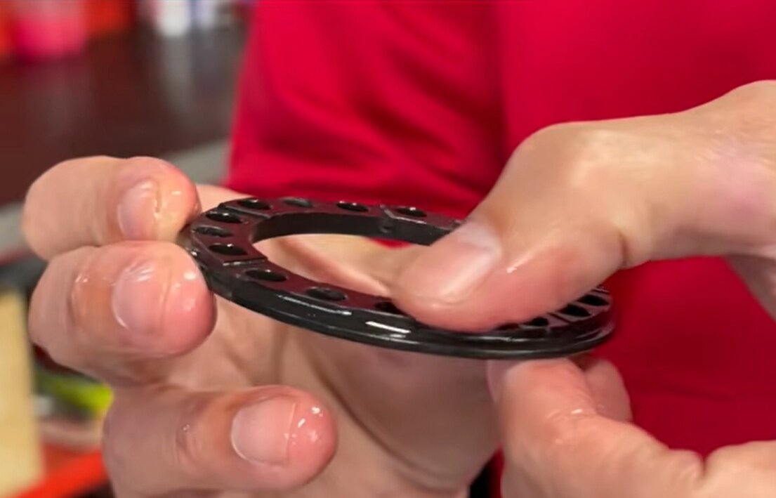

stevec Posted January 24 Report Share Posted January 24 It looks like the belleville spring support "ring" (#15) sould be offered in different thicknesses, similar to what TRS does. They only list one so far. 1 Quote Link to comment Share on other sites More sharing options...
nhuskys Posted January 25 Report Share Posted January 25 I believe it is like the Beta enduro clutch.... There are three positions for #17 to adjust preload on the spring. 1 Quote Link to comment Share on other sites More sharing options...

stevec Posted January 26 Report Share Posted January 26 14 hours ago, nhuskys said: I believe it is like the Beta enduro clutch.... There are three positions for #17 to adjust preload on the spring. Makes sense - great design. 3 Quote Link to comment Share on other sites More sharing options...
