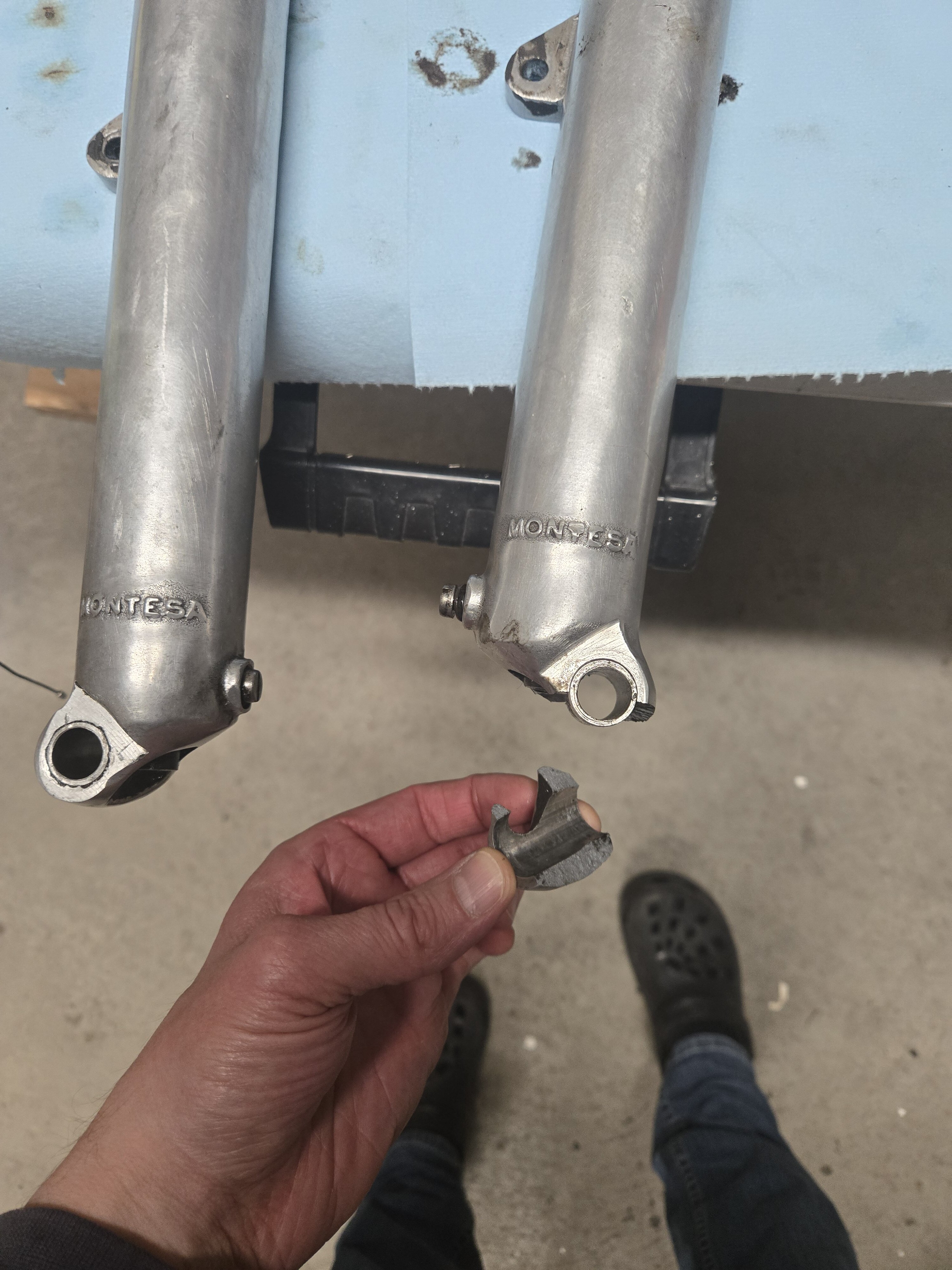

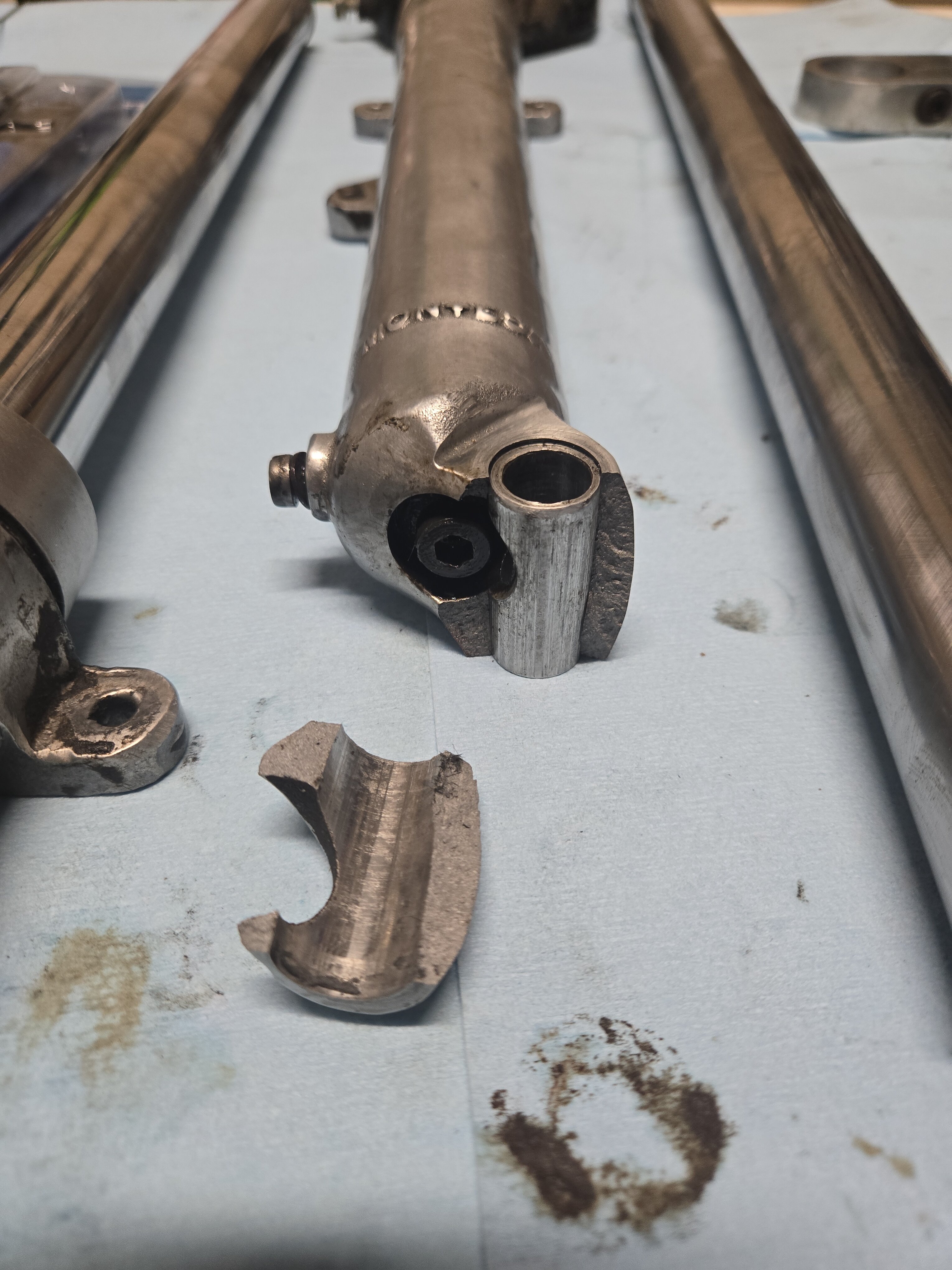

I broke the bottom of the lower fork on my Montesa rebuild.  ChatGPT told me to hammer down....the forks come up.... I should have realized but didn't.
I heard about welding but I think here in Alberta, CA it would be very expensive and no warranty or guarantee.  I see exact parts on ebay in the US that look almost new.  They look too good to be true but I assume I could rebuild the forks with new seals... Or is it best to try to get an entire fork - upper and lower?
The old shocks seemed to be functional 25 years later. Any recommendations would be great.
The lower fork legs wear oval in the bore after years of use depending on how often the oil was changed, measure the bore in the lower legs for true to round before investing in a weld repair.  Very few will have the tech to weld that material efficiently.

If the bores are oval, you can have them machined to take modern Teflon coated bushings, or bronze.  But, it would be much easier to find a replacement.

Thanks ALL - I ordered the lower leg on EBay - I can always repair it later if needed. $115 seems safe and it looks like new, just like my current forks.
