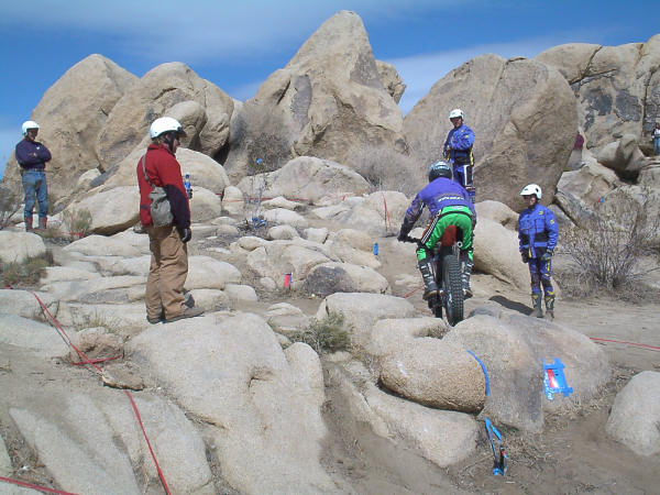

It is worth noting the purpose of a specific rule. As I see it, the rule about a missed section penalty requires that you actually ride your bike around the loop and go to each section to get your 5 punched. If there wasn't a more severe penalty for missed sections, you could have a bike problem or injury that should force you to dnf but instead you just would get 5's for missed sections and be recorded as finishing. The intent of the rule is to force you to actually ride the course if you are in fact competing. NATC is a 10 point penalty for a missed section, in FIM it is 20, in the Scottish it is 50 (this trial obviously has greater emphasis on riding the course and finishing).
Regarding the rule about riding sections in numerical order, it is the rider's responsibility to ride the course in the correct way and go to each section in order and to pay attention that you have arrived at the next section and haven't missed one. I realize that some clubs may relax this rule, especially if they are small and ride with group scoring, and that is up to them. But if you have a trial that has many riders then safety dictates that you need to have everyone riding the loop in the same direction else chaos! Better that the rule is in here and a club can say it doesn't apply than to not have the rule in the event it is desirable.
Regarding the gates on trees where you can't see the back side, this is a problem of learning how to mark a section in the best way. Often the problem can be avoided by the layout person by just marking so that "you must go here" so as to avoid the need to be aware that "you must not go here". But I think the best designed sections are those that don't require a blizzard of markers like that. Better to just send the lower classes off to ride some ground to one side and the upper classes off to ride some ground nearby with a minimum of intermingling. But good section layout is always going to be a bit of an art. If you do it you will always make mistakes, just try to be open minded and ask people who are riding and try to learn from your mistakes.

"There can be some discussion there as to what 'passing through a gate' means, but it was described at our meeting to treat these gates as though they are like a yellow ribbon inside the section, dividing where the riders are to go."
I would describe "passing through a gate" the same way as at a section entrance or exit--if the front axle brakes the plane, you've passed through the gate.
Edited by MalibuDon
Well, one of the specific incidents that came up, Me riding, Dan Brown standing there with Ron Milam and Brian Robison as the observer.
Go down into my turn and pull a nose wheelie and land with my rear wheel in (past) the "gate" of another class. (I did not realize that there was a gate there)
