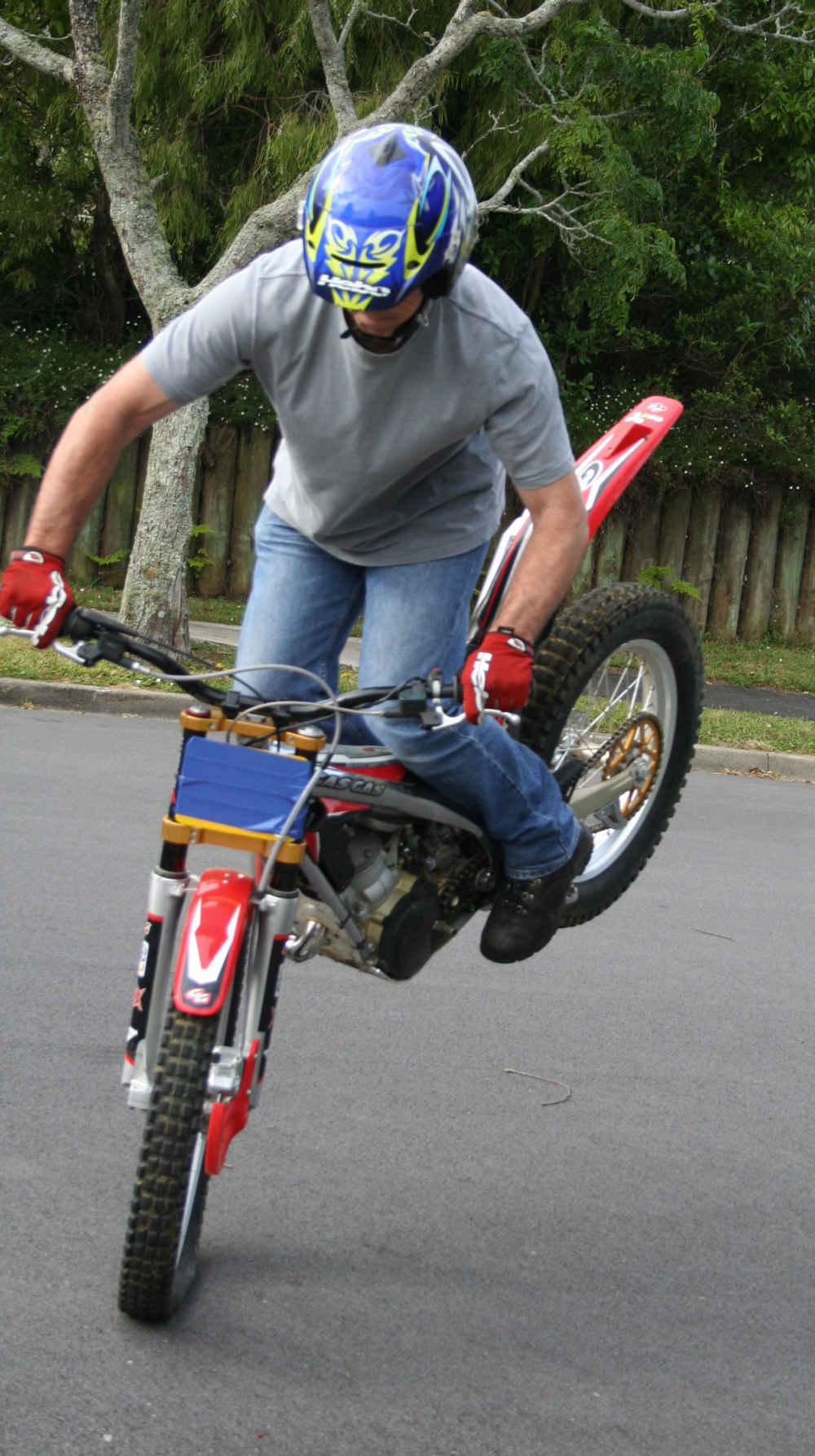

Pic taken last night (and I was worried that I wasn't getting the rear wheel high enough). That wasn't a "static" hop but a stoppie with about a meter run-up:

The best tip is to make sure that your suspension is set up correctly. (The photo above has the perfect travel, try fiddling around with the rebound setting).
