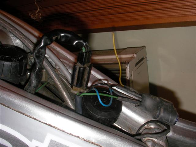

right, the wire coming from inside the bike are the wires from the stat. the wires going to the left are the wires going to the fan. the yellow wire sticking up is the wire inquestion that iv been told is supposed to be the live, any help?
Edited by Jonno
ok i have found what seems to be a live, if i piggyback the loose wire from my fan onto this live is it likely to effect whatever the live wire is going to? as in not give it as much power? or will more power be generated to compensate for the loss??
Seems I recall the fan power has to pass through the rectifier as it is a DC motor.
Get a proper schematic !
Where is RON? He knows! :beer:
here is a wiring diagram here for the techno. All you have to do is register to the site which is free!!
