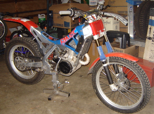

My 97 Section is in excellent condition, fast throttle, power valve works fine, strong compression, added optional flywheel weights to smooth out power delivery, and it does NOT lack power!
Tony P
Thanks Rock Hopper.
I really like this 97 Fantic. I only paid $500 USD for it!
I put a new rear tire, fast throttle tube and new grips.
I wish I could find a set of new decals for it.
I'm fairly new to trials, prior to this Section,
I owned a 74 Honda TL125, a 75 Yamaha TY 250,
and a 91 Fantic 309.
So for me this bike is a big step up!
Tony P
Unionville, NC USA
Try and get a flywheel weight and a slow action throttle for it, coz they are a bit of a handful, but they are an awesome bike!!!
$500 What a bargain.

It does have the flywheel weight installed, but I prefer the fast throttle tube, I have tried both.
Tony P
