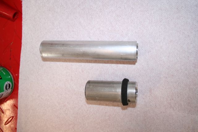

I have success!! Thanks for all the help and it worked like a champ. Found a 14mm socket that fit perfect, heated the hub a little on the bearing I wanted to get out first, fliped it over, put in the socket and gave it a smack out out she came. I can see how that inner spacer for the rear has a lip on it. The front was easy as the inner spacer just pushed to the side and a drift took the bearing right out. I've attached a pic of the front and rear spacers so those that haven't seen them out can see what they are. The rear is on the top.
