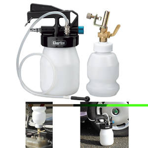

So you guys have trouble eh, what if you had to bleed hundreds of bikes?
Well this is the sort of thing they used at the Scorpa factory (see photo)
Where possible the systems were built and bled off the bike first, there was a rack with the master cylinders clipped at the top and hose and slave cylinders dangled below, that way gravity lends a hand I suppose!
This one can be bought from -
http://www.machinemart.co.uk/product.asp?p...47&r=2056&g=107
