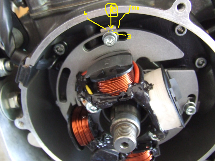

This stuff is not rocket science, but it IS somewhat sensitive, so here is a reference pic with notations.
All measures are eye reference only, but you have a nice screw right there with a 4mm hole in the hex for a guideline.
I always set mine back 6mm on a new one(center of screw), but after installing the Boyesens on the '07 it almost seemed TOO soft, so a bit more fine tuning to my liking was due.
Taking it back to about 4mm from std(as in piccie), things started to get pretty aggressive again , not bad, but not quite as smooth as I prefer, so I settled upon the 5mm mark, sweet!

I just finished the timing mod and ran the bike around the back yard for an hour or so.
From the factory marking, I moved the timing back by 7mm (measured as accurately as i could with Digital caliper). I also happened to move the bars more forward as suggested in another thread.
The change in timing made a big difference. The bike was much more rideable and also with the bars more forward and i felt in more control (quite noticeable).

copemech....i just revisted the photo you posted.
In the '03 2.9 I just did the timing on, the factory 'mark' on the plate was lined up against the right side of the aluminium post that the allen screw goes into.
(I am sure that the flywheel had never been off before)
That is what I was trying to represent with the first dot on the right side noted STD, that does not mean Sexually Transmitted Desease! Ha!
Thats exactly the same as my 04 250 was before I changed it, there were no marks on the paint on the flywheel nut to make me think it had been off before.
Copemech, i've looked at your pics and you seem to be moving the backing plate clockwise (from your pic) if you want to retard the ignition you rotate the backing plate anticlockwise, it would seem your advancing it not retarding it.
