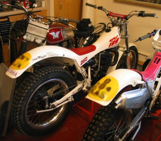

That has put me in the mood to unearth one of my RTL250's!
It's in here somewhere...
Big John
For those of you who are interested. This is me and my dad riding my Honda after we put it back together the last time.
Great riding spot. Thanks for sharing.
BJ I saw your comment on youtube, and I agree, nothing wrong with the bike when it's hot and has vomited out all the excess oil, then it runs brilliantly
And you have three very nice looking bikes there, the RTL looks like a minter. I think Conny bought my bike from John Shirt but not exactly sure, is it the same with yours?
