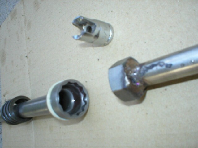

Followup on all these good tips:
Last week without tool, I just put it back together and rode it. I got to it this weekend, stripped the forks, only to find the replacement seals were 1 mm too small OD. Cleaned it all up and reassembled, awaiting new seals.
1. Air impact tool = Duh, took the CP out of the bottom drawer and it came right out. Inner rod did turn a bit though. I use the impact gun for flywheel and crankshaft gear nuts, but never crossed my mind.
2. On the second tube, I tried Charlies broom tip just to see. Tried with tapered end, straight end, and with some wadded up duct tape. Didn't work, but after I took the damper out (with air impact) I could see the hex part was very shallow. Had I done a very short steep taper it might have worked fine.
3. Once apart, the proper tool is obvious. As suggested, the hex nut is the ticket. 22 mm is correct, .866 inches across flats. In US, a 9/16 nut is odd, but available, and is .875 across flats. I welded it to about 18 inches of 1/2 inch OD stainless hydraulic tubing, and welded a cheap 3/8 drive socket to the other end. This works great for the final, proper tool to reassemble and tighten. (And I will get to use it all again when I get the proper seals.)
I will attch picture below.
4. Also shown is a tool for the TY175 dampers. These have an oval cast end 5/16 across flats, but longer in the other direction, so a socket won't fit. I took a 5/16 8 point socket (for square head set screws), and ground out the sides as shown. Use a 12 inch extension and it works great.
5. The outside hex on a 13/16 spark plug socket is almost 22 mm, but appeared to be a tight fit into the damper rod. I could envision getting it stuck in the rod and pulling off the socket extension. Then there would be parts down hole blocking getting the proper tool onto it, so I would not go that route. However, sticking a 22 mm nut halfway into a stadnard 22 mm socket (with tape or somthing behind and around it) would I think work for those without a welder. Or put a couple nuts jammed onto a bolt with the proper head size, and put a socket on the double nuts.

Pics of the damper tools. I hope. kcj
