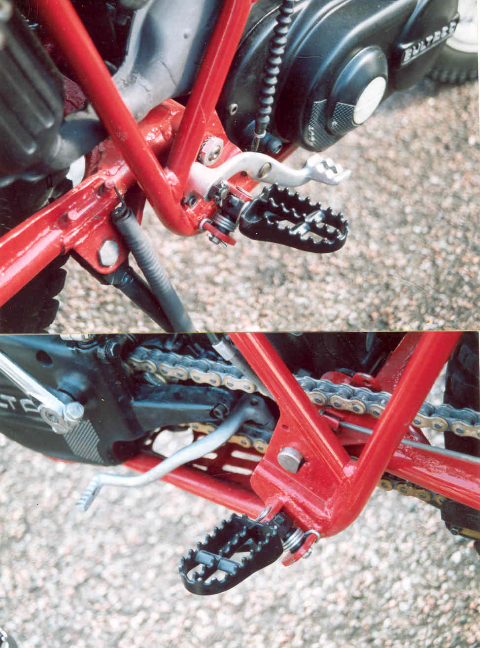

I saw a neat conversion to Hebo footpegs on a Sherpa at the SSDT last year,pic attached.
