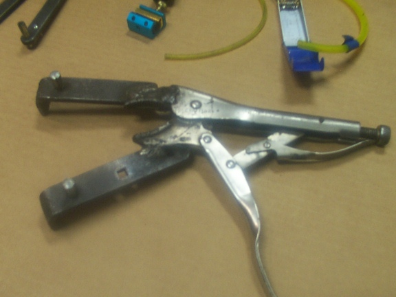

I've got a torque wrench, I just don't have a way to hold the flywheel.
I'm a vintage Hodaka Trials rider so I'm not able to visualize the flywheel you've got. But I'd bet you could bend up your own flywheel holder tool out of 1/4" steel rod. That's what I did for my Hodaka. Even a garden variety propane torch will provide enough heat for easy bending at relatively precise locations.
Made this years ago. Flat bar side is for clutch basket, sprockets. Round dowel pins fit slots of alternator rotor.
