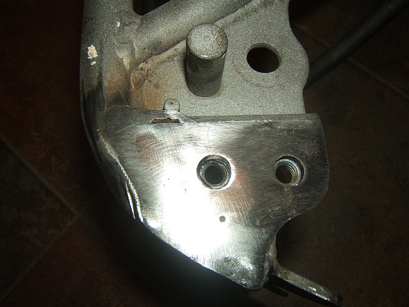

wayne_weedon Posted March 7, 2009 Author Report Share Posted March 7, 2009 4282 is real late, would have an ally head steady i bet.maybe in the last 100 ever made? Yes it has the Alloy Head steady with the extra mounting point on the top tube. A huge improvement over those early Snapalot steadies! Well it also now has nowhere to mount footrests!! Just welding in some captive M8 nuts to mount brackets onto. The existing hole (Tooling hole probably) is quite convenient for this mod. Needs an extra hole slightly further back to make it usable. Wayne.... Quote Link to comment Share on other sites More sharing options...
wayne_weedon Posted March 7, 2009 Author Report Share Posted March 7, 2009 (edited) Mod completed both sides, at least it's reversible. I'll tidy up/blend the remnants of the Factory weld (Top of hanger) when I can find the dremel! Wayne... Edited March 7, 2009 by wayne_weedon Quote Link to comment Share on other sites More sharing options...
nigel dabster Posted March 7, 2009 Report Share Posted March 7, 2009 good idea. looking at that side further up the tube we weld a bracket which lines up with the middle box weld a nut on there and do away with the bracket on the rear engine bolt which does the same job but a pain to get at. Quote Link to comment Share on other sites More sharing options...

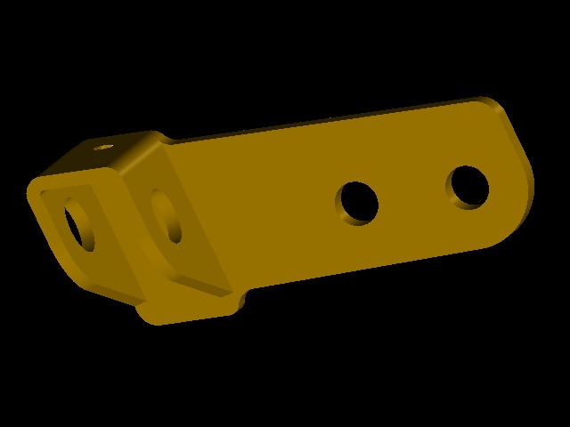

wayne_weedon Posted March 10, 2009 Author Report Share Posted March 10, 2009 Not quite got it to the painters yet! Too much "proper" work getting in the way this week. But I just spent a few minutes modelling up a footrest hanger. Pic attached. It should work ok. Wayne... Quote Link to comment Share on other sites More sharing options...
