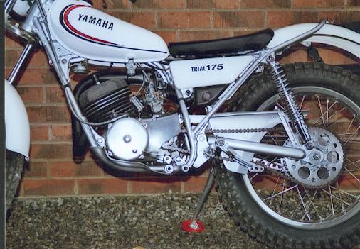

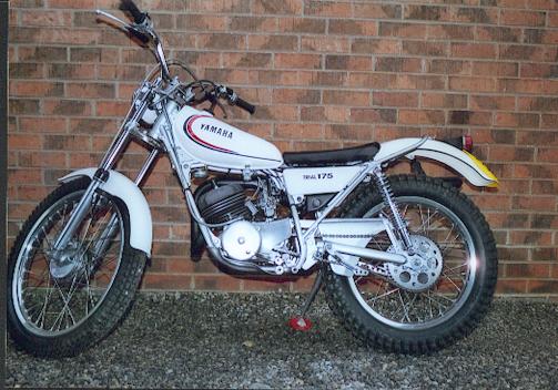

Reason I'm asking is my TY175 is quite tidy, needs rear shocks and a rear mudguard a few cables but apart from that it will do me for the up and coming Classic twinshock rounds.
I find it hard to stop myself from 'going the whole hog' and spending
Very nice Johnnyboxer, Fair play mate.
