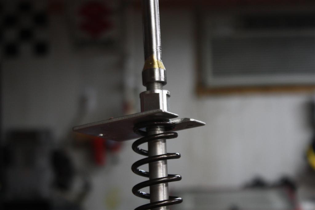

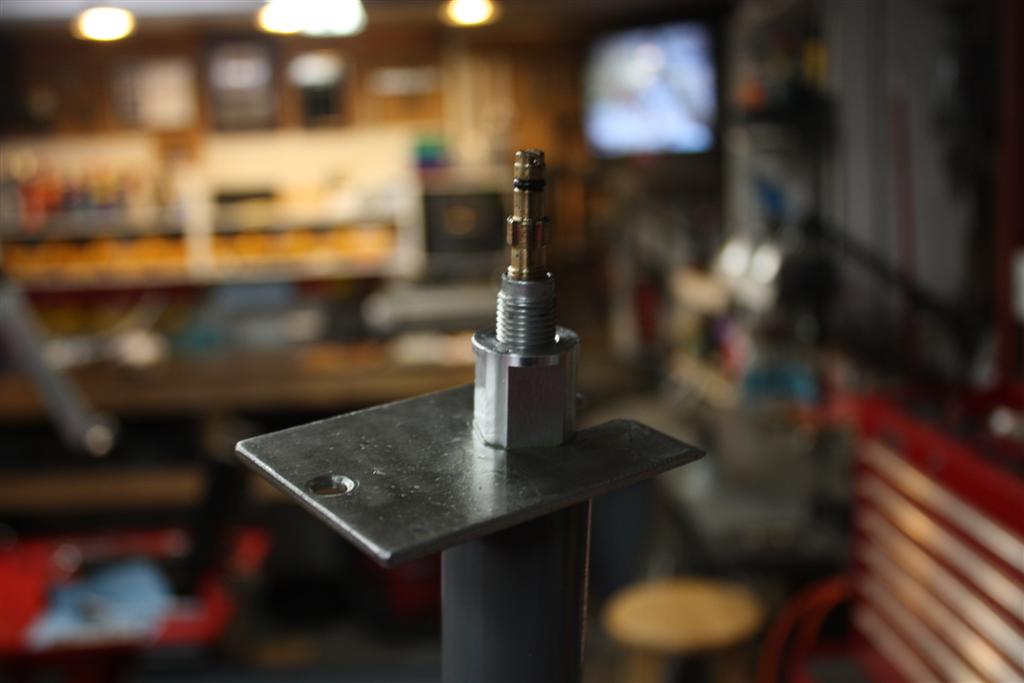

They are fairly straight forward except that you will need to set the oil level and not use volume. You will need to remove the spring to set oil level (180mm for steel tube and 160mm for aluminum tube Marzocchi's). If you make a simple tool like this aluminum plate it will make messing with the spring a lot easier. Pull the spacer down and insert the plate, then you can remove/install the top cap easier. They also take a pin spanner to remove the top cap on most of the Zokes and use a little heat to break the o-ring bond. The top caps only are tightened to finger tight.
(the tool on the top of the damper rod is used to bleed the cartridge easily)
Jon
In the last photo I just had the plate in to keep the rod from dropping down but here it is above the spacer:

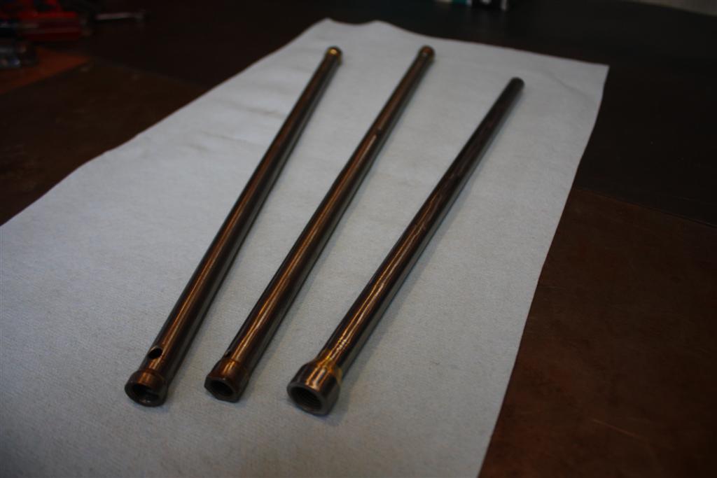

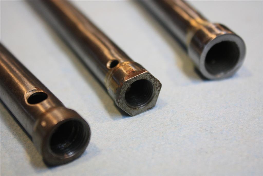

A bleeder rod is a very handy tool to have and you can make your own like I do. Find a nut that fits the threads on the top of the damper rod (where the top cap goes on) and braze or weld it (I braze and machine in the lathe) to a piece of tubing.
The photos are of bleed rods to fit 5 different types of damper rods. The Marzocchi is on the right and does not need holes on the side and is about 10 inches long. The other two are about 14 inches for Kayaba, Showa, WP etc and need to be longer to reach down into the longer tubes of that type of suspension. They need bleed holes on the side as the damper rods hold fluid and it is pumped out the top but the Marzocchi's don't work that way so no holes needed.
The bleeder rods really make it easy to bleed air as you don't have to chase the rod when it disappears down inside the tube and then try to get a good grip on it with oily hands. It also makes it easy to pull back the spacer and insert the plate so you can attach the top cap.
