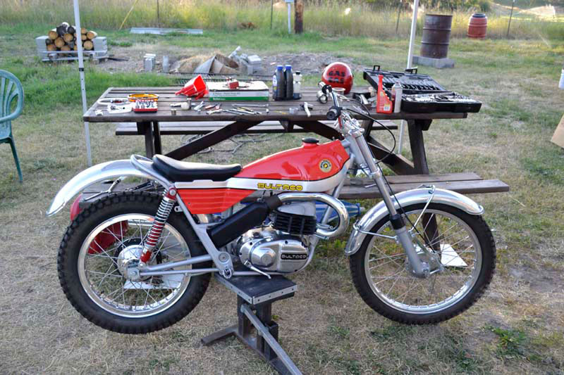

I tried to post a photo of the bike from my website but it said it wasn't allowed. Theres a picture at www.customknives.net/net/MOJO.htm Thanks.

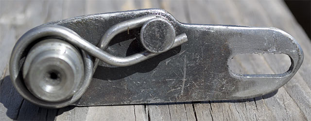

Heres a quick pic.
Thanks,
Jeff
When you screw the selector plate back on with the 3 screws, the rotating peg will engage the pawls that sit behind it into the selector drum. The peg should be pointing upwards at around 12 o'clock position and will move side to side from about 10 - 2 o'clock.
When you then push the selector shaft assembly on, the spring should sit either side of the rotating peg which then sits in the slot in the selector. When the selector moves left or right the spring tensions against the peg and returns it in either direction after a gear is selected. There is only one way it will fit really. When fitting the selector, just move the rotating peg with your hand to position it so that the peg engages in the slot.
Check that the shaft isn't bent. Although it is only short, the gear lever is quite vulnerable and can get caught and bend the shaft - which could also cause it to stick as the spring would not be strong enough to return it if it is bent where it comes through the casing. Your gear lever needs to be set at 2 o'clock, it's at about 5 at the moment which is the number of minutes it will last if you ride it like that...

I've been making things with springs for over 20 years, but I'm not getting this. I didn't remove the plate with the 3 screws as the shifter began working
when I initially loosened 3 of the case/cover screws. From that I figured that there was a bind between the inner case and the cover. So I took the shoulders down
a bit shaft assembly. It seems no matter how I put the spring back on I don't get the return I had when the tension was off the case. .006" shouldn't make too much difference
in that regard. Feeling like a dough-head at this point and running a magnet over the ground looking for something...
This isn't rocket surgery... maybe just a long day...
The spring just doesn't look like its on the shaft right. There was a gap in the spring between the shoulder the the pin that's on the shift pawl/assembly. About the size of the lug that's screwed into the case. Jeez...

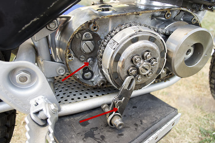

Hi, I am only doing this from memory, but I think the spring tangs are on the wrong side of the pin on the shifter shaft. If they are in the correct position they create a 'hole' or round gap which the arrowed pin on the engine will fit into. All my Bultacos are together so I cant visually check for you
Hope this helps, Greg
Yes, it's possible. I'll check when I get home tonight
Thanks Guys.
This is true, I had spring reversed in the picture. It can only go on the bike as in the first 2 pic's below. I think #3 is probably where the spring might have been hitting a boss in the case, no biggy. I remember seeing the gap you mention before I pulled the spring off to turn the shoulders back. If I do get the assembly back in and manage to get the lug in the case between the springs, as in the second picture, there is a big gap between #1 and #2. Resulting in slop of 20 degrees or so.
Tis a mystery...

Yep, it must have been a long day.
This works. DUH.
Thanks Guys.
